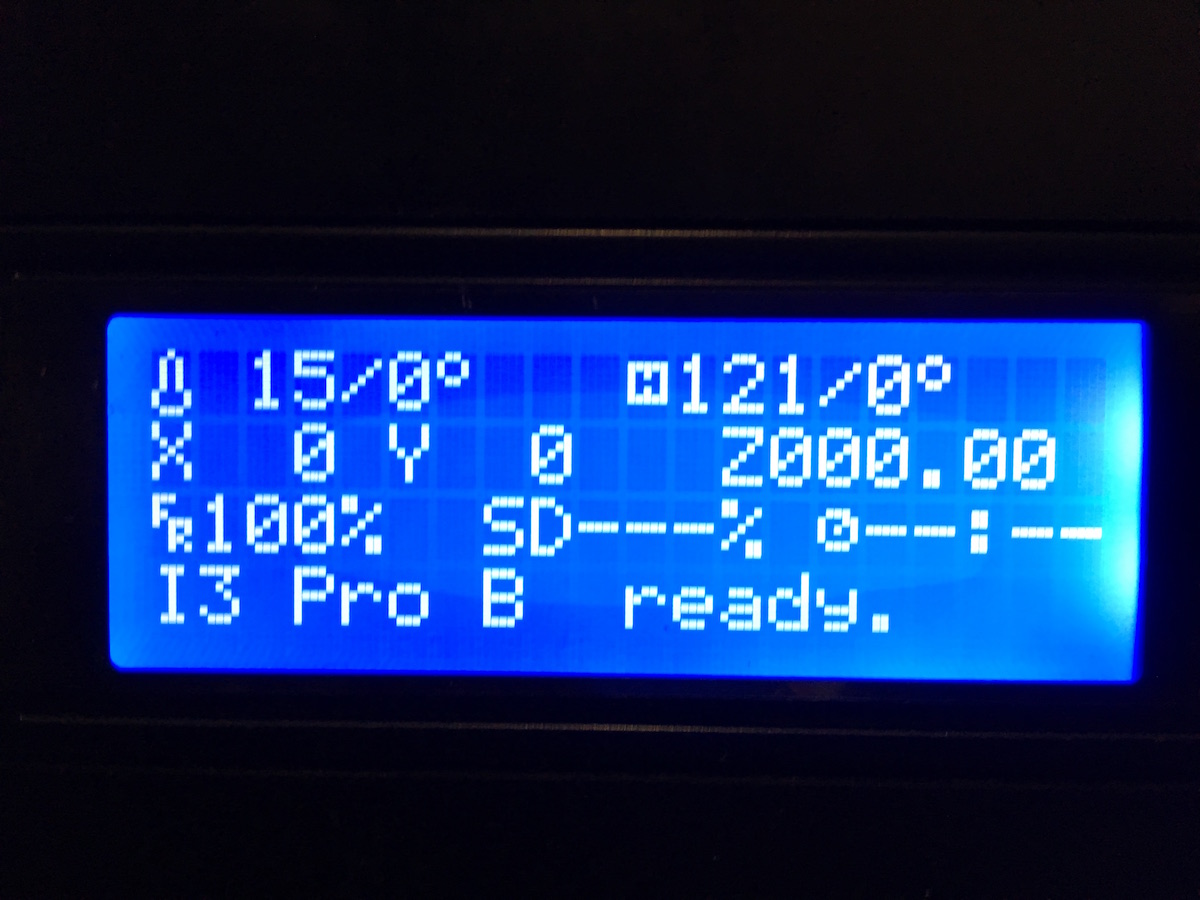

Hi all,
Sorry if this case has been studied here before but after searching for a while I couldn't find a possible solution to what's happening to my GT2560.
The question is that since yesterday the hot bed temp is stuck at 121º/0º even when the room temperature is warm or cold. For example, the extruder sensor says that my room temp now is 15º but the hot bed is always 121º...
I have short cutted the thermistor and it shows 358/0 as suggested on other post to be OK, but I can not find anyone with this issue.
I hope someone could help me on this!!!
Pasted Image 0 copia.jpg (209.78 KiB) Viewed 6384 times
Kind regards,
Manuel.

Bad thermistor?

If I remove the thermistor the temp still marking 120-121...
I'm trying to update firmware with no luck at the moment...

Bad board?
You can refer to this post to check the socket on your board:
viewtopic.php?f=23&t=17030
