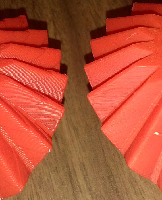

I found a big difference between Lulzbot Cura and the Cura that comes with Repetier. The Cura with Repetier loses X,Y registration. I have trashed several prints that shifted from one layer to the next.
Lulzbot Cura is better.
The gear on the left was sliced with Repetier's Cura and the one at the right sliced with Lulzbot'sCura. Both use 0.15mm layers.

I slowed the travel speed from F9000 to F6000 and the displacement of layers stopped. Cura is fine.
