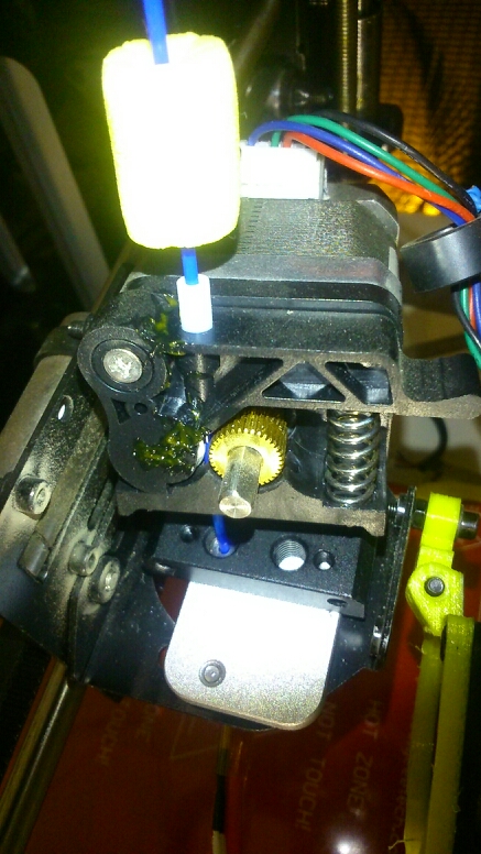

hello,
i've some cracks that appears after a few printings near the bearing
the filament move now very bad

Could you attach a picture of it?

i'glued the cracks to try fixing it i send you the picture this evening

Re: cracks on the feeder
here is the picture i tried to fix with neoprene glue but it doesn t seem to be strong enough the feeder under extrude filament
- glued cracks
- crack.jpg (285.78 KiB) Viewed 12243 times

Okay...I guess you can contact the seller to send the replacement feeder?
