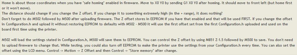

So it sounds like your modifying was not saved to the firmware?
Maybe you can check if the following tips about M500 and M502 work:

mk22000 wrote:Hi bang and thanks for your fast reply.those commands about M500 is for changes from repetier host i think?i didnt try out through repetier host yet.i try through configuration.h with epprom disable and from lcd with storage memory and check that my new settings has saved also after reboot but my problem is the extruder doesnt extrude correct again even after new settings.i chech the spring of the extruder and tension looks good,i dont kniw what else...
Yes,i mean in Repetier Host.
Did you check if the display for step/mm changes after your modifying?
And did you try swapping a driver A4988 for it and try the following solution?
