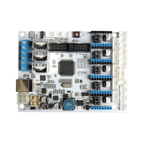

hEY i JUST SAW YOU POST YOU BOARD if IS SAME that MY ONE WITH BLUE CONNECTOR if , they move the 3 pin down to the left side of the board hat one is for touch sensor.

Ah, there's a new version of the board out in the store. It must have come out after I ordered my Pro c last fall.

this one is the one I have, I still working on the firmware to make it work, do you have any lik for this the one that I have is kind confusing.
GT2560 look the new one.
