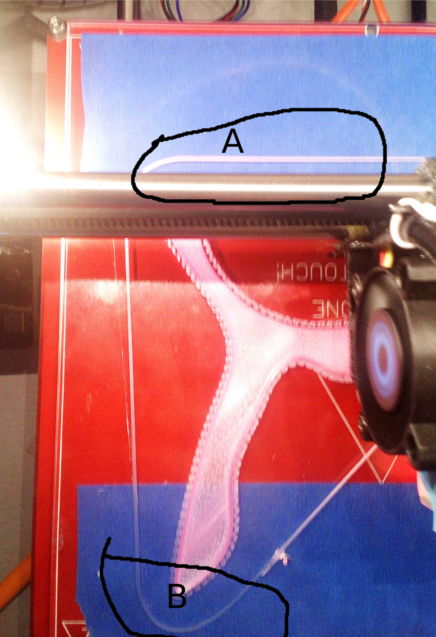

I am getting strange auto bed leveling results, the leveling is uneven and it affects the print quality.
Here is an example :
I activated brimming for this print.
On the picture you can see 2 zones : A and B.
- On the A Zone, you can see that the brim width and thickness seems quietly correct : the nozzle was not too far and not to close to the bed when it as been printed.
- On the B Zone, you can see that the nozzle was really too close to the bed, it's really thinner than the brim on the Zone A, it looks more transparent.
The problem is always the same : the first layer on bottom left side is always (too much) thinner than on top right.
What does it imply ?
-> When I want to remove my part, the first layer always stays stuck to the bed in this area and the part eventually breaks there.
-> When I print large parts, the filament cannot be extruded properly and it sometimes clogs the nozzle.

I have the same issue in the same area. I think it is a firmware problem. I've opened a dialog with the firmware creators to see what's going on.

I have the same problem.
After performing a G28, G1 Z0, I carefully leveled the bed manually with feeler gauges to 0.2mm gap at each corner, and then rechecked after a further G28, G1 Z0.
I then performed a G28, G29, G1 Z0, and by issuing G1s to each bed corner I rechecked the gap and measured 0.2, 0.1, 0.05, 0.2 at the corners and 0.2 in the centre.
Is there a configuration setting to adjust the matrix algorithm?

I am surprised that the bi-linear algorithm is not extrapolating to the un-probed areas. I think that maybe the linear option will be better.
Will run some tests today.

Made further tests.
Bed manually leveled with feeler gauges to 0.15mm.
After homing and running G29 (linear mode reading 4 points), Z0 now gives 0.25, 0.15, 0.1, 0.1 at the probe measured spots on the bed.
I think I will give this a rest until the firmware has been sorted. Reducing my active work table down to 185 x 150mm because of probing limitations is not worth it.
I will continue to use 3DTouch for Auto Home and not use G29.
My bed is level enough when done manually, but using the 3DTouch for homing lets me fine tune nozzle clearance by changing Z Offset on the LCD. I keep a chart of offsets/clearance values.
