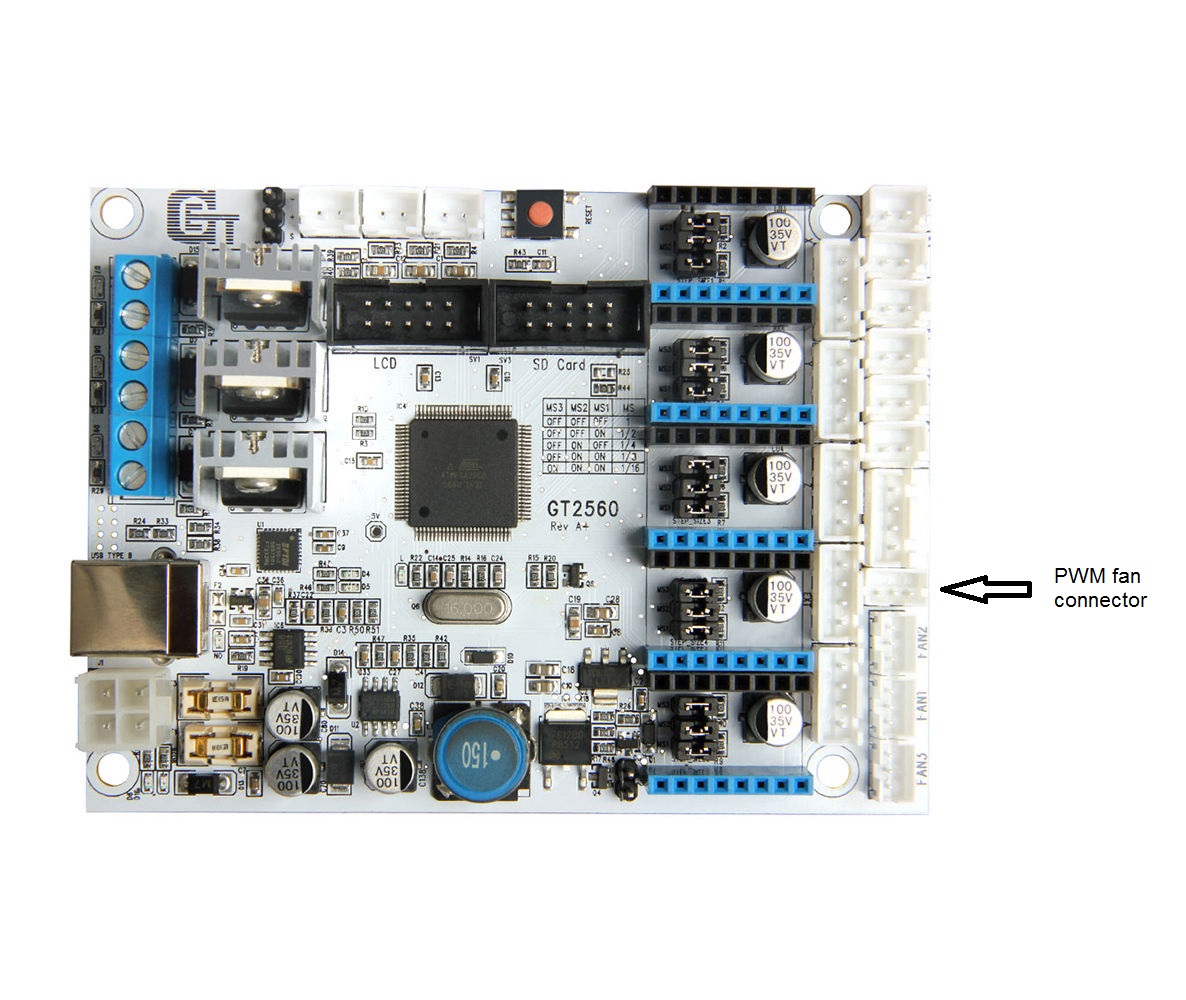

I would also like to find the schematics for the A+ board, but I think it isn't that simple because there is at least three different versions of this board. I have three A+ and all look slightly different and all have some part variation.
I fried one of mine through accidentally shorting the 12V fan output, as a result all the fan outputs suddenly got 24V and not 12V. Initially I thought that the A and A+ boards were similar in this respect and so I thought that the D17 was causing the issue and looked for that diode but could not find it. In a desperate try I removed the 7812 thinking that OK, there is no D17 at all... so the 7812 was bad, but no... then I checked a little more and seen the Q4 (A5sHB p-chanel FET) right of the 7812, checked and noticed that it was bad. After I removed it the board is working 100%. I ordered new parts and that's it, it is now repaired but for the future... it would be good to have the schematics.
BTW, you are incorrect about the lack of PWM. It works but only with one fan.
[attachment=0]GT2560-PWM.jpg[/attachment]
If it is not working for you then you might have the wrong Marlin configuration.
