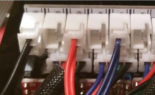

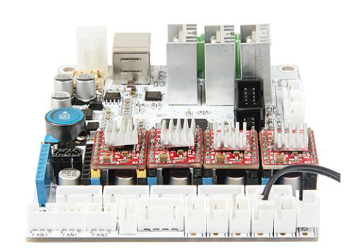

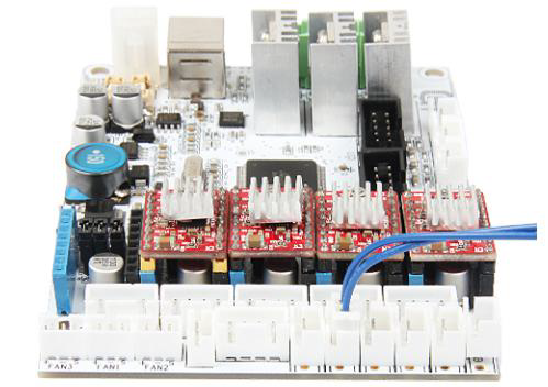

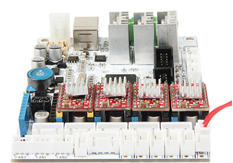

Thanks, your solution worked after I rewired the endstops and uploaded the default firmware. When I was working on it I thought there was something wrong with the endstop wires because the manual showed this:
