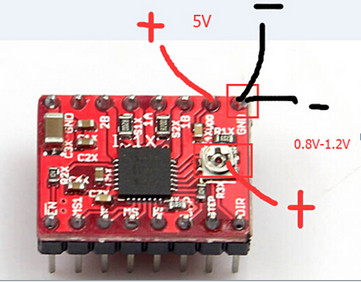

I've read that one can change the torque to the stepper motors by adjusting the potentiometer on the driver board. I was wondering if this was true, and if so, how to do it.
I was shown this picture of it. Thank you!
download/file.php?id=2190

just adjust the potentiometer on the A4988,you can increase the voltage and change the torque.

Yes, I was wondering how. Does turning the knob clockwise or counterclockwise bring the voltage up or down? And by how much? Thanks!
Re: Driver Potentiometer and Torque
you can measure the voltage by the multimeter.
