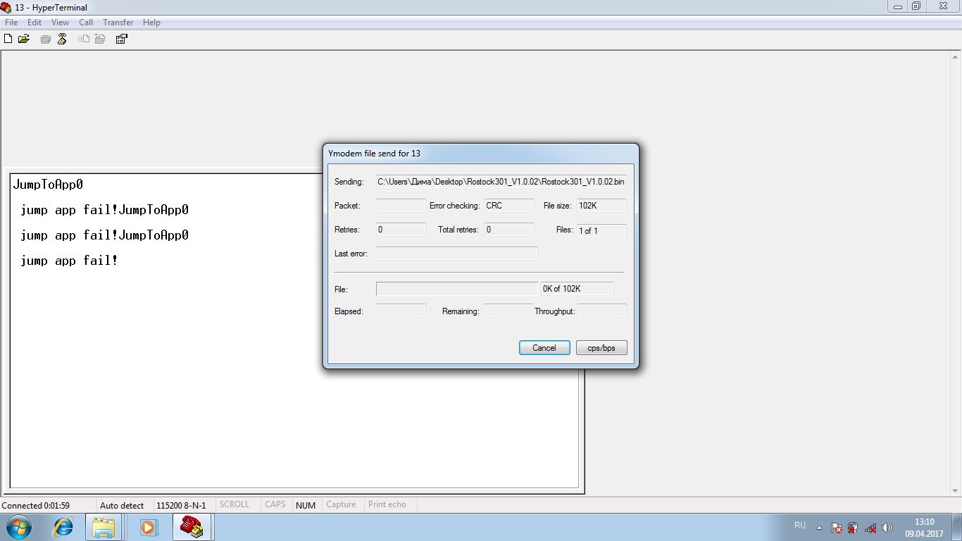

here what occurs at a payment insertion what to do?
- сбой при записи прошивки.jpg (101.05 KiB) Viewed 11450 times
- запуск прошивки.jpg (122.69 KiB) Viewed 11450 times
Re: 3d Printer 3 in 1 insertion
Hi,it seems to have some problems in the firmware,and you can download the lastest and re-upload it according to the post in the following link:viewtopic.php?f=20&t=18167.Please let me know the latest situation,Good luck.

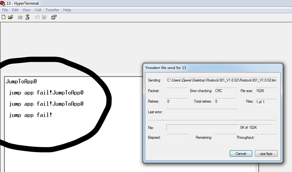

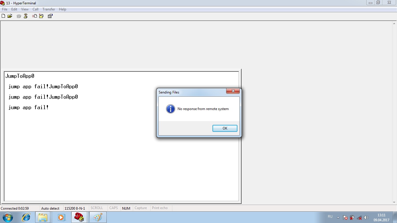

I just tried to go too far the printer according to this instruction
- IMG_20170410_132121.jpg (93.11 KiB) Viewed 11428 times
- at implementation of this point I have a mistake
- IMG_20170410_132155.jpg (349.56 KiB) Viewed 11428 times
Hi,According to the pictures show, it is because the mainboard is not in burning mode, please take a closer look at the post,especially point 4 and behind. Before getting into burning mode you need to let the mainboard reset .You can click and hold "C" button on the keyboard to reset the board.It also will be okay if you press the reset button on the board directly.
At me everything has turned out, thanks for the help
