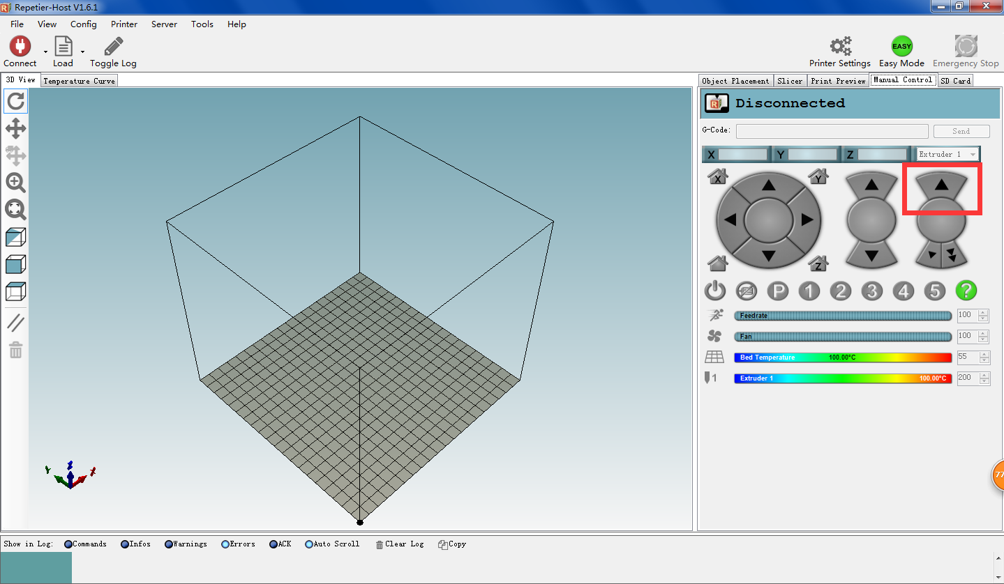

2、Filament Hard to remove > To remove the filament,you can reverse the motor of extruder by maunal control in the Repetier Host.Just like the attachment shows.
