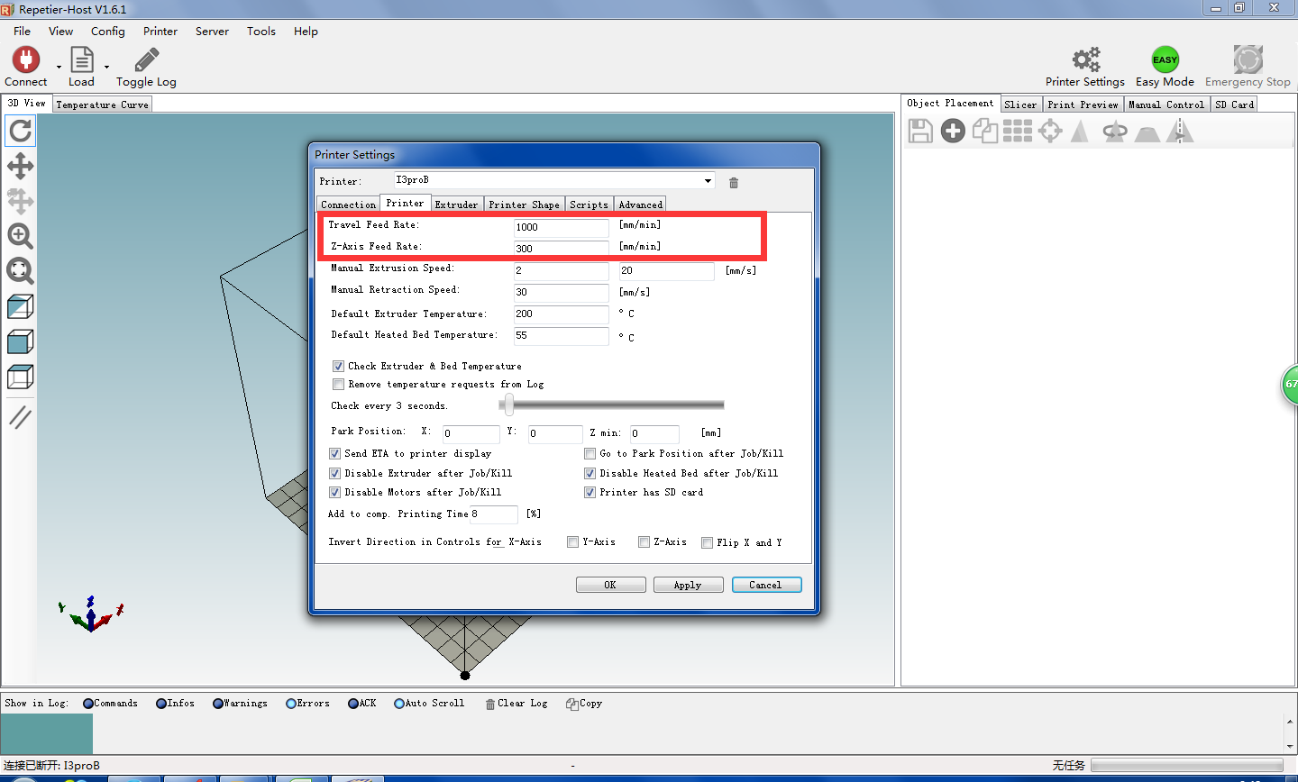

Hi,you can increase the value of printer setting in the Repetier Host to increase the printing speed according to your actual situtioni.
- 1.png (114.29 KiB) Viewed 5099 times

Have tried that still does not work, even the firmware is et up correctly and has such values declared within it.
If the maximum printing speed stated in repetier host exceeds that set within the firmware would it by error not go beyond minimum?
If I am using the wrong pins file for the board will it cause the same error?
