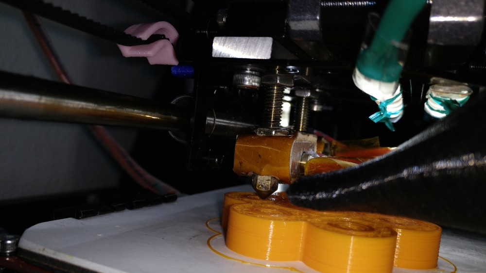

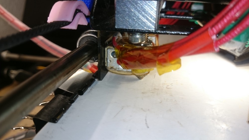

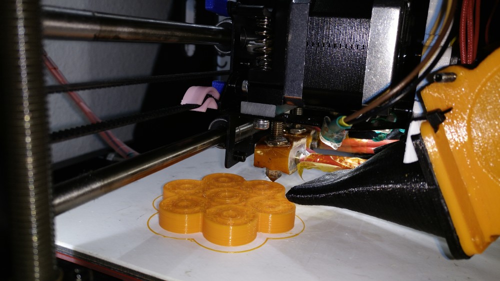

hey there,
i was able to solve the issue.
i disassembled the whole printer head. i unscrewed the heatbrakes and had a closer look how the stepper motors are mounted on the aluminium "bridge".
since the bridge has to be screwed to the black metal plate from below (there is no place for the screws elsewhere), i had to rethink.
the initial idea was to get rid of the big offset of the bridge. so why not make a thinner one?!
i went to my trusty workbench and made a new one:
the original bridge is 5mm thick + 5mm high feet on each side --> get rid of the feet!
after a few hours of measuring, sawing, drilling, threading and sanding the brand new bridge v2.0 was finished...and BOOM, it WORKES just fine
(i first thought about sawing the feet away, but if something goes wrong, i can't use my printer any longer...)
see the pics for proof
