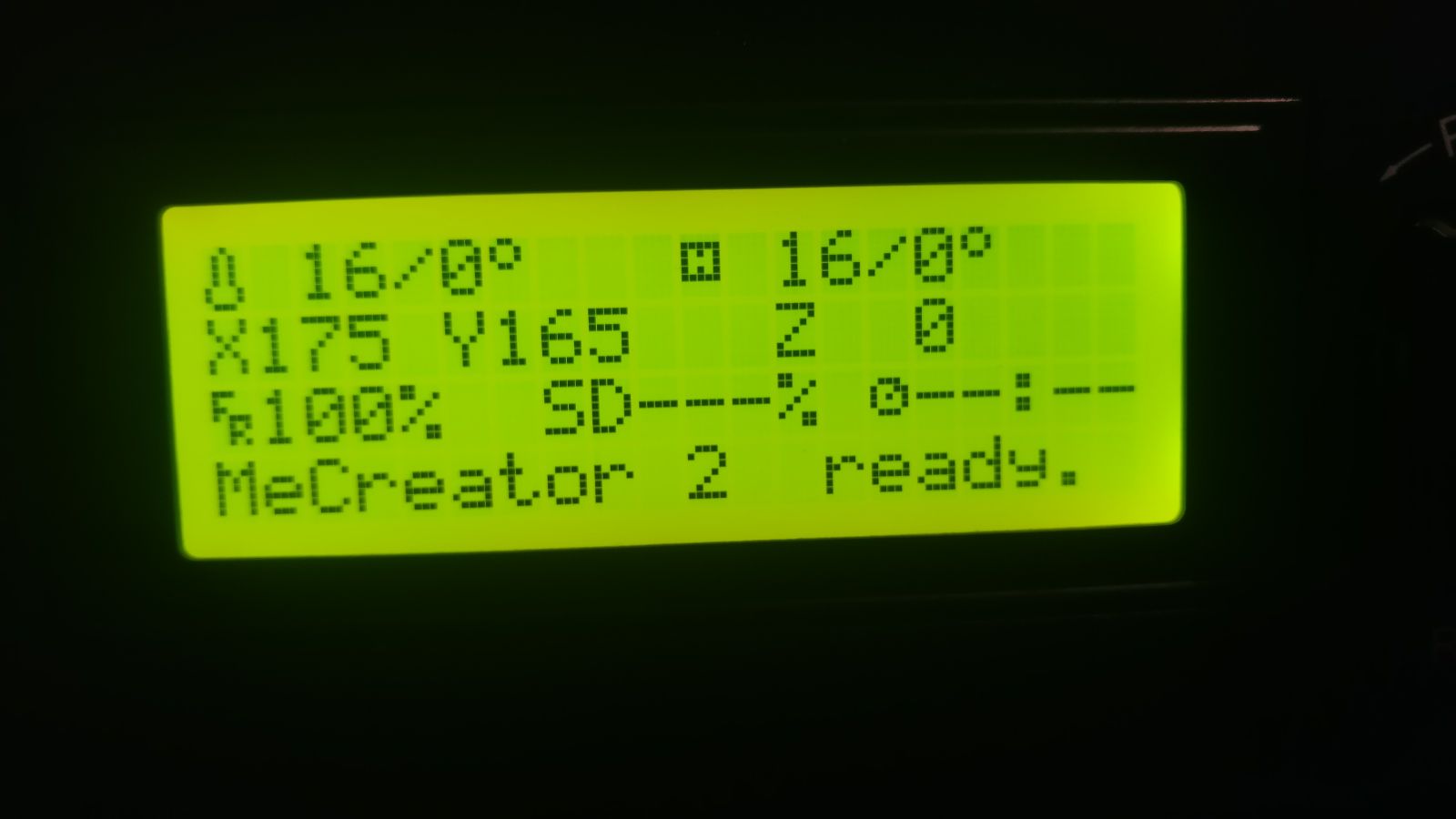

go on the lcd and go to ''control' and then press the ''Restore Failsafe''
and then try to home it. and post a picture of what the lcd says when its homed

Here is the picturezlyna123 wrote:go on the lcd and go to ''control' and then press the ''Restore Failsafe''
- WhatsApp Image 2017-05-26 at 00.42.29.jpeg (58.61 KiB) Viewed 15616 times

I would say just try to run a print after you have "restored failsafe" and see what happens. I had the same problem.
And btw if this works, and you want to center the printa on the build plate, u just move the x-axis to 10. The y-axis to 0 and the z-axis to 0. And then press set home offsetts in the menu. U will hear a loud beep. And then the next time u print it will be centered
