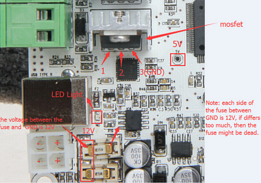

Hello, can anyone help with finding 5v pins and GND
I would like to connect a relay of 5v to the GT2560
Can i use one vacant endstop? are they 5v?
Thank you

Hi,here is the position of 5V and GND.

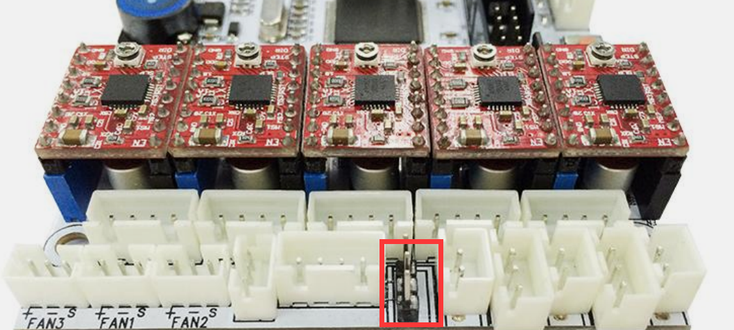

by PauloSilva
Is that a 5V PIN? what is the number of the PIN?
thank you

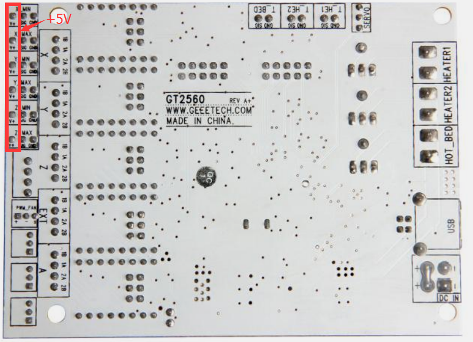

Re: GT2560 5v pins and GND
Posted: Fri Jun 02, 2017 11:20 am
by William
You can use the rest endstop pin of the board.There are actually 3 pins on the postition of endstop connector .Remove one of the connector from the board and replace it with a 3pin straight Pin.You need to use soldering iron here.Then you can use the +5V pin.
