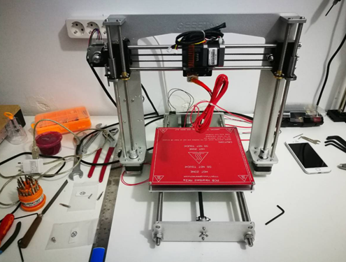

2、Unboxing and assembling
After ordering what do you receive? A flat box of about 12 Kg weight including almost all the parts and tools needed to assemble the 3D printer. Really the included tools are just a set of screwdrivers not sufficient to complete the assembly; You need also a tester (maybe useful in the final part o to check the cabling if something goes wrong), a set of Allen keys if you like to work better than using the provided tools a plier and a 17 key for the y-axis nuts. Take a look to the work in progress image below
Assembly of the printer is not so difficult but a minimal mechanical experience is a plus especially for the registration phase of the axis parts and motors and the tooth belts tensioning.
To assemble the printer I have followed the support material(https://www.geeetech.com/Documents/Prus ... uction.pdf) provided by Geeetech.com freely downloadable from their site and the videos available in a progressive playlist on Youtube(https://www.youtube.com/watch?v=KCKfAqo ... _DPNh3KWgj).
2.1、Box and assembly instructions
I should say that the box content is very well organised; every kind of screw, nut, washer etc are in a separate numbered plastic bag; this simplifies the assembly also to those not used to the traditional components nomenclature; there are different length M3 and M4 screws, different kind of nuts, washers etc.
The limitation of the manual is in the few availability of images describing the assembly procedure of some parts. This limit is compensated by a complete series of video instructions; unfortunately this how-to shows the instructions for the model I3A (not the Plus version). 90% of the instructions are identical with some very intuitive exceptions but the last part showing the electronic assembly is completely different. In this new model the electronics and controller, display and power switch are in a separate box while on the Aluminium printer frame only the connector board should be placed. It is easier but may create some confusion for the first time user.

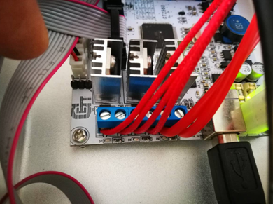

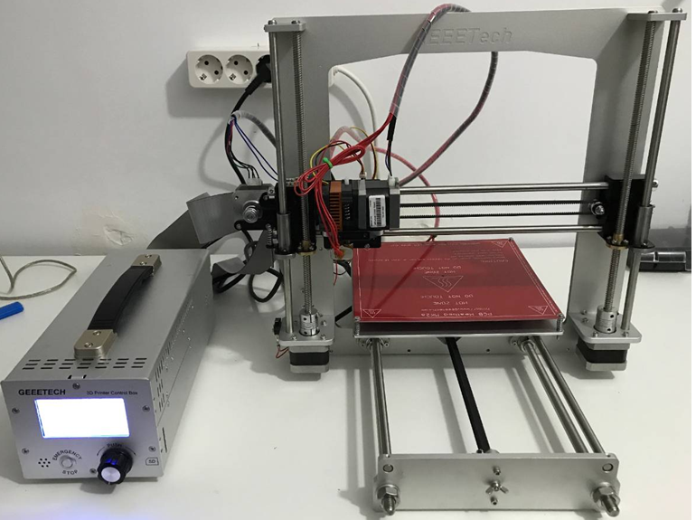

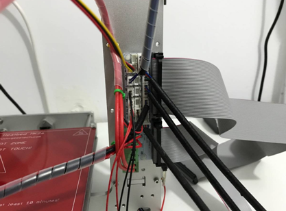

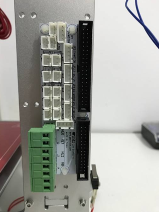

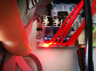

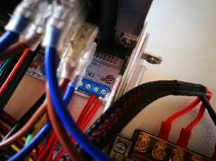

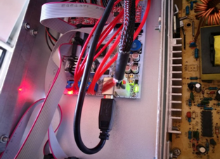

As mentioned above this Prusa has the entire electronics in a separate box connected to the printing frame through a couple of flat cables to a connector board. This part is very appreciable not only because it is easier to work but also because it reduces the number of wires on the printer making the movements easier to control.
3.1、What's in the box?
The electronic control box is shipped preset and preassembled. Obviously I have opened it. All the components are organised well with a good aeration. It is far from an "untouchable stuff"; any problem that will occur during the use of this 3D printer it is not easy to check the electronics and eventually replace the parts. I have appreciated the availability of the PCB references almost clear for all connectors and test points, including a number of useful LEDs to monitor the activity of the device and the signals. As expected the main board - redesigned by Geeetech - is Arduino based and experienced users can manage the firmware without difficulties. In past I had no difficulty to ask to them for a copy of the sources to make testings and some improvement, adaptions etc.
What I have found it is the case to review in some points is the board firmware. The printer works very well with the Repetier software and Cura (but I prefer Repetier with the Cura slicing engine) but the wide display has a lot of space that can be used to show some more information than those actually shown.
The lack of the firmware installed on the main board only affect the display so as a matter of fact there are not limiting or blocking problems in the system functionality.
The first issue is the auto home function: it works well if you launch from the printer menu but seems having only effect on the Z-Axis when it is launched by the printing script via G-Code
The second issue (almost annoying) is that after awhile the x, y, z axes positions are not updated correctly.
What instead I have appreciated is the correctness of the preset pint values on the board. You can start printing after the assembly is finished without trying to see if the steppers sequences are set correctly.
The pictures below shows the box open an running.

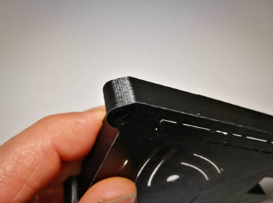

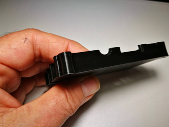

4.1、X-Axis belt lock
Usually it is a 3D printer component while in this case I see it is a robust plastic one. It influences the stability and tension of the X-Axis belt and the belt fixing and registration is extremely simple.

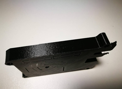

4.4、Print test
The images below shows a print test as it was done and removed from the heating bed.
Printing conditions:
Nozzle diameter 0.4 mm
Print speed 55 mm/s
FIlament Geeetech PLA diameter 1.75 mm
Layer thickness 0.2 mm
Type of support: Brim 5 mm wide

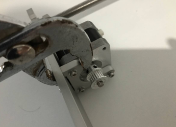

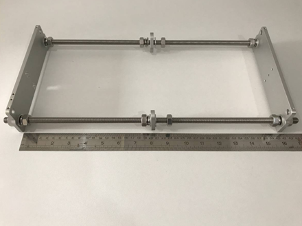

6.2、Y-Axis front and rear sides misalign when I close the nuts
This seems a stupid problem but it happens. We should take in account that when we lock the four nuts on the horizontal screwed bars there are two nuts on the right side and two on the left. But all the nuts closes rotating in the same direction (clockwise). To avoid misalignment while firmly closing the nuts you should use two keys and close them crossed. Not only but on the right side keep firm the most external nut and rotate with the key the internal one. Do the opposite to the other side.
Conclusion: the rotating (locking) nut should always be the one that has no influence on the locked plate position. The same is valid for the middle group locking the vertical frame of the printer.
The internal distance between the two Y-Axis sides should be 40 centimetres for the full use of the 200x200 mm printing surface. While closing the nuts check the distance on both sides.

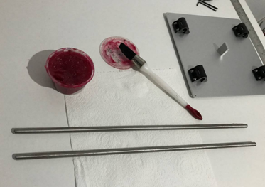

The bar screws and moving bars are not required to be treated as all the sliding parts uses linear bearings. I have experienced instead that for a better duration (and zero noise) it is the case to paint a thick Vaseline neutral mechanical grease. I have found this product investigating what is that white grease that last for years on the moving parts of the modern ink jet printers. It is sufficient a very thick paint to get a good result.

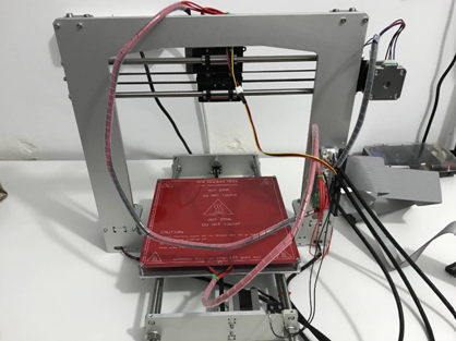

One of the most important things to pay attention to avoid wrong 3D printings is just the bed calibration. Take in account that the heating bed is a PCB (heating) on top of which you will fix a 3 mm glass plate that is where the 3D printing will be built.
Calibration needs to be done almost frequently and it is an operation that it is not difficult to experience in few time. Placing the heat bed in the right place while assembling the 3D printer can make the difference; it is sufficient to follow these two easy steps:
1. Fit in place the heating bed red PCB keeping the four spring in about the middle of their maximum compression. When calibrating if the springs are too high the bed become unstable while if they are too compressed you will have difficulties lowering the bed during calibration.
2. After you have put the springs in an average identical position using a precision (metallic) ruler or - better - a caliper check that all the four screws keeps the heating bed at the same distance.
I have verified that the optimal distance of the heating bed from the Y-Axis driving plate is about 15 mm. It is not important that the distance is exact but it is important that you keep the same at all the four corners as much as possible. With the caliper, to do this make the first measure then lock the ruler and check the remaining corners as well.

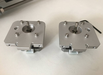

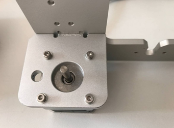

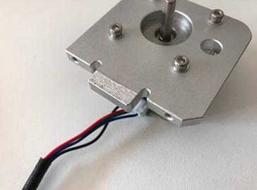

6.6、Z-Axis: how to setup correctly
One of the most influencing aspect for the quality of the 3D printing is the correct alignment of the couple of motor screw drivers for the z-Axis. Following a similar method as explained in the previous point, after the Z-Axis mechanic has been set in place in an average way complete the alignment of the two motor screws using the most precise measure tool you have. Only if the two screws are perfectly aligned your tool will work perfectly.
