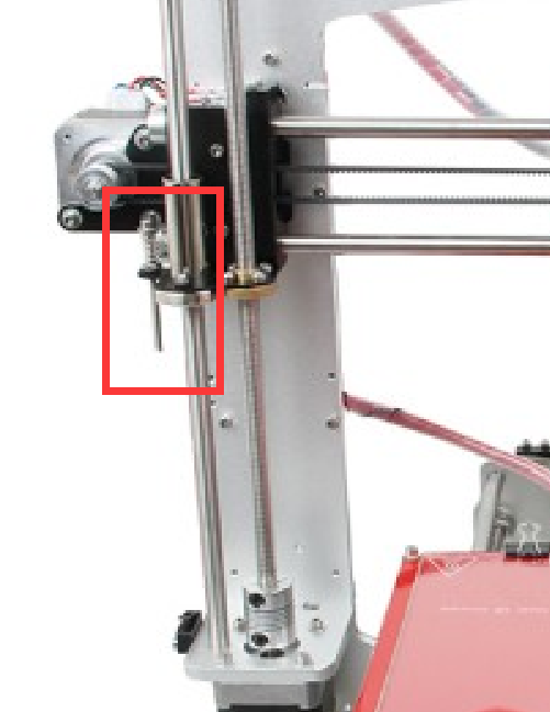

After you calibrate the hotbed,the first layer should be printed in the home position.So It really sounds weird.Have you adjusted the screw which is used to trigger the Z axis' endstop like the pictures showing?

Yes, I adjusted this screw but without result.
However I saw in a forum that someone to change a value, and apparently it fixes the problem, I changed the Z step to 2560 by 400 and apparently. Why am I forced to change this parameter ? Is there a wrong firmware 8 mm rod ?
