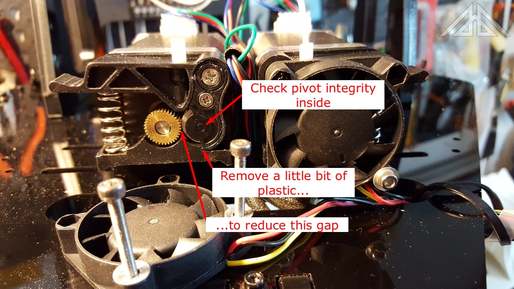

Unfortunately, this is exactly what happens to me, too. Printer is an Aluminium Prusa i3 A.
Re: Clogging every time i print
Under this situation,we use to clear Interior of nozzle first,and then squeeze the screw which presses the filament,I guess your printer problem come from lacking of screw pressure.

If you are talking about the screw on top of extruder to adjust the tension spring, my printer has not it.
Info has been marked on the picture.
