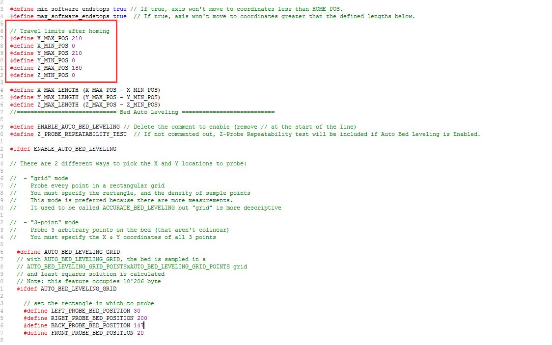

i got a problem while adapting my firmware for my new 3DTouch sensor.
i own a geeetech i3 pro c (dual) and i successfully installed the sensor (after a few hours...)
currently i can G28 (home all axis) fine.
but with G29 (autolevel) my x-axis is going crazy and ignores my build dimensions completely:
[edit: new link]
https://www.dropbox.com/s/ojgai588y35oh ... l.mp4?dl=0
it doesn't matter if
define X_MAX_POS 180 (current profile)
or
define X_MAX_POS 130 (just testing)
the printer always moves over the limit and the belt is tortured
suggestions are welcome :-)

but during the auto-leveling (G29) it starts with a big x-offset and then runs all the way to the right, making contact with the frame.
and as i wrote: it doesn't mater, if i'll put in the correct dimensions (x=180) or if i'm shrinking the build volume to a fictitious number (x=130 or less)
so where is my error?

I'm sorry, the link above is broken. here is the new one:
look carefully at...
t=7sec --> autoleveling 1st point is not even close to the edge
t=15sec --> head moves too far to the right and makes contact with the frame.
for detailed analysis, i'm posting my Configuration.h file here.
hopefully, you can find the issue
BIG thanks!

#define X_HOME_DIR -1
#define Y_HOME_DIR -1
#define Z_HOME_DIR -1
#define min_software_endstops true // If true, axis won't move to coordinates less than HOME_POS.
#define max_software_endstops true  // If true, axis won't move to coordinates greater than the defined lengths below.
// Travel limits after homing
#define X_MAX_POS 180 // 185
#define X_MIN_POS 0
#define Y_MAX_POS 170
#define Y_MIN_POS 0
#define Z_MAX_POS 180
#define Z_MIN_POS 0
#define X_MAX_LENGTH (X_MAX_POS - X_MIN_POS)
#define Y_MAX_LENGTH (Y_MAX_POS - Y_MIN_POS)
#define Z_MAX_LENGTH (Z_MAX_POS - Z_MIN_POS)

    #define LEFT_PROBE_BED_POSITION 30 //ORIGINAL: 15
    #define RIGHT_PROBE_BED_POSITION 200 //ORIGINAL: 170
    #define BACK_PROBE_BED_POSITION 147 //ORIGINAL: 180
    #define FRONT_PROBE_BED_POSITION 20 //ORIGINAL: 20

Re: 3D Touch G29 ignoring x-axis limitation
Which model is your printer? Pro b? I think the parameters of "Travel limits after homing" should be this I show you.

as i wrote above, my printer is the pro c = dual extruder.
and since it's printhead is bigger i can't use the original numbers you advised me to use.
i used the manual printer control and measured out my REAL printing dimensions by moving the printhead around and then taking the max. values.
i came up with these (yours may differ) :
Code: Select all
#define X_MIN_POS 0
#define Y_MIN_POS 0
#define Z_MIN_POS 0
but as i wrote above:
my problem is, that somehow during G29 (auto-leveling) the printer either...
a) ignors the X_MAX_POS
b) uses a too big x-offset - as seen in the video, the first measure-point is near middle the bed instead of front right
c) sets every measure-point wrong --> how exactly can i manually set the measure-points? my guess is, it has something to do with this...

I GOT MY ORIGINAL PROBLEM SOLVED!!! - sort of... ^^
the important code is this (your values may differ):
Code: Select all
    // set the rectangle in which to probe
    #define LEFT_PROBE_BED_POSITION 0 //ORIGINAL: 15
    #define RIGHT_PROBE_BED_POSITION 170 //ORIGINAL: 170
    #define BACK_PROBE_BED_POSITION 135 //ORIGINAL: 180
    #define FRONT_PROBE_BED_POSITION 0 //ORIGINAL: 20
here you'll define a rectangle, within the auto-leveling is happening / the auto-leveling grid will be calculated.
these values -sadly- have to be set independently from your original printer volume settings (X_MAX_POS etc).
...well, my original problem is solved - only to encounter the next problem:
as always: suggestions are welcome.
theoretically, i need to set the measured probe offset for x (16mm) and y (-41mm) axis.
--> "if the offset is in between the (first) nozzle and the end-stop, then if has to be negative"
but with every value i tried, the results are getting worse - except for one: ZERO offset:
Code: Select all
  // these are the offsets to the probe relative to the extruder tip (Hotend - Probe)
  // X and Y offsets must be integers
  #define X_PROBE_OFFSET_FROM_EXTRUDER 0 //ORIGINAL: -25 // measured: 16
  #define Y_PROBE_OFFSET_FROM_EXTRUDER 0 //ORIGINAL: -29 // measured: -41
  #define Z_PROBE_OFFSET_FROM_EXTRUDER -0.1 //ORIGINAL: -12.35
as i said - theoretically... because the results turn out great!
for now, my problem is solved and this thread can be marked as [SOLVED]
