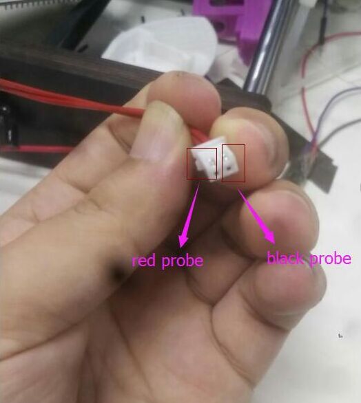

I think you can measure the resistance of the thermistor. Just pull the temp wire out from the extension board of extruder and use a multimeter to check if the resistance is about 100K as I show you.
- measure the resistance of hotend.jpg (29.64 KiB) Viewed 11662 times

I measure the resistance of the thermistor as you guide, it is not connected.
I also measure the resistance of the heater wire it is about 4.1 Ohm.
However non of the extension board on my extruder has voltage at the heater connector.
Does it mean teh sensor is die and therefore the board do not supply the output for heating register?

Re: Rostock 301 The extruder/ Print head not heat up
If the resistance of the temp wire for extruder indicates the thermistor is open, you can contact the related seller and replace a new one.caotri wrote: Thu Aug 31, 2017 12:22 am Hi,
