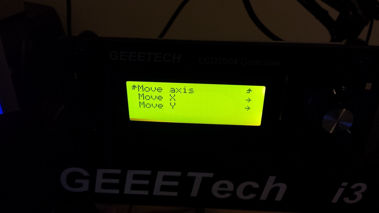

So I've just bought and assembled my first 3d printer. I followed the instructions and it took a while but its all finished.
The problem I am having is that the z axis is not homing. When I use the printer and tell it to home, it moves both x and y to home but z shifts up a cm then stops. I have no z optiob in move screen either. Same when I plug it in on usb. I have put new firmware on it but it was the same before (hence why i updated).
Could I have installed something wrong?

You do not get the option to move the Z axis 10mm, only 1mm at a time from the display.
In the video you said Z kept going to zero? Is the end stop plugged into the correct port? Are the wires on the correct pins on the switch?

I worked out that I had the z axis end stop plugged in wrong. So that mystery is solved.
But I still have no control over the z axis from the lcd display.
Re: I3 pro C no z movement
I think you should re-upload the firmware for your printer. The post you can refer to:
http://www.geeetech.com/forum/viewtopic ... 10&t=17046
