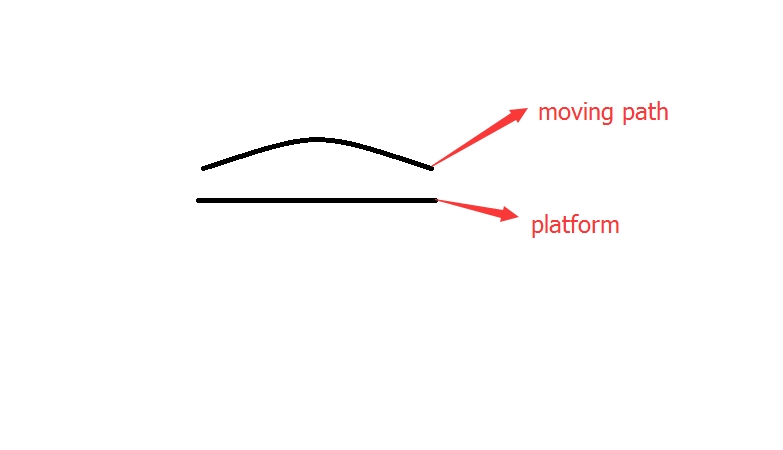

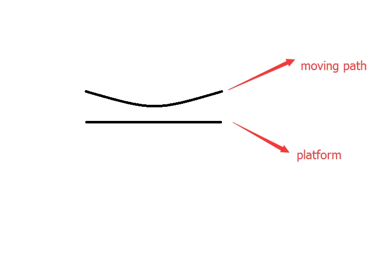

When the nozzle move to the 2 3 4 point and continue to move the 2 3 4 point to Z 0, if the nozzle has touched the bed, The moving path is convex surface.So you should increase the Delta Radius. If it not touch the bed, the moving path is concave. So you should reduce the Delta Radius.
