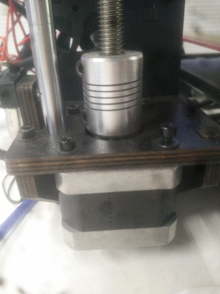

Re: Z-Axis Problem, Couplings run irregular
I think you should mount the couplings as I show you. The shaft of the motor should go into the hole of coupling more length.
