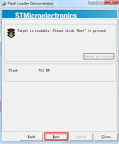

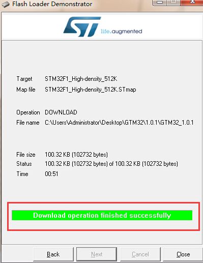

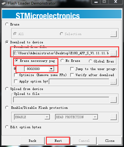

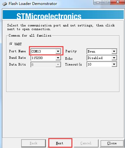

1. Download the software Flash Loader Demonstrator and install it.
http://www.st.com/en/development-tools/ ... stm32.html
2. Burn the firmware via Flash Load Demonstrator. (version-1.11.11)
3. Access to the motherboard power supply.

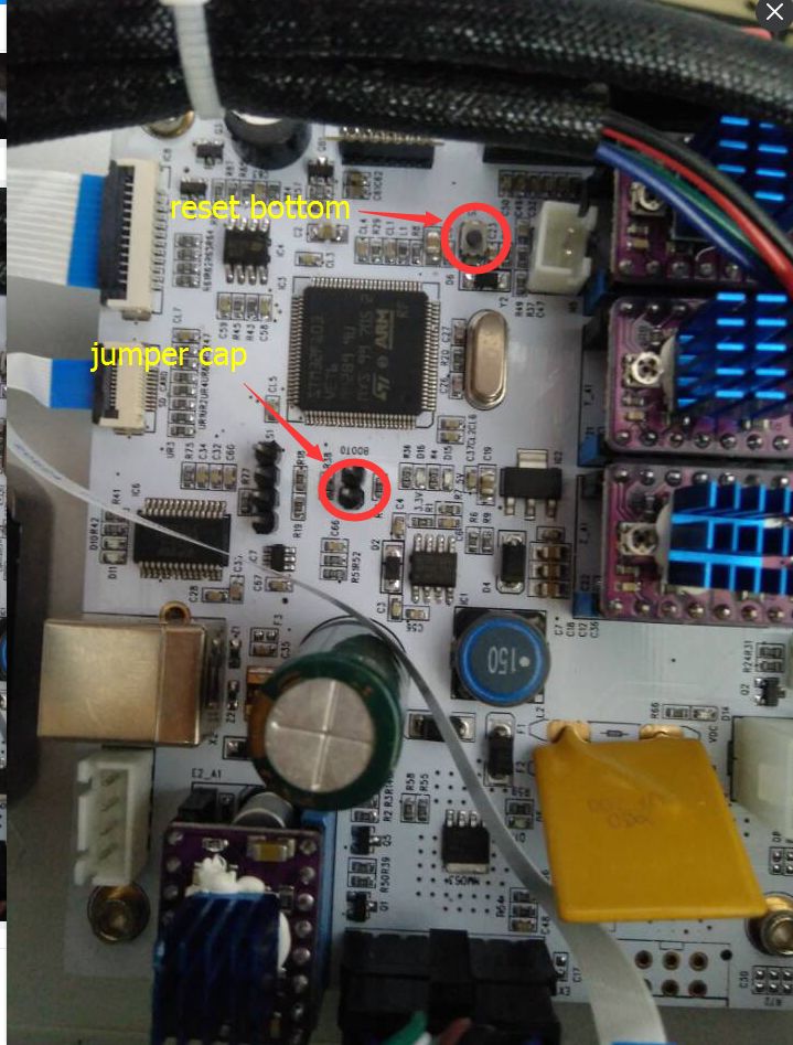

4. Insert one corresponding jumper cap on the boot0 of the board.
Connect the USB cable.

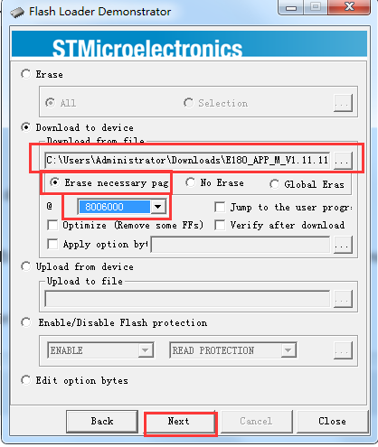

Press the RESET button 5.Open the Flash Loader Demo, confirm the COM port, for the rest do the setting as default. Click the Next. 6.Choose the firmware"E180_APP_M_V1.11.11.bin" and check the "Erase necessary pag" radio and the address "8006000" and click Next to install it. 7.Then we start to burned the second file"E180_APP_S_V1.11.11.bin"

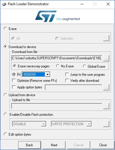

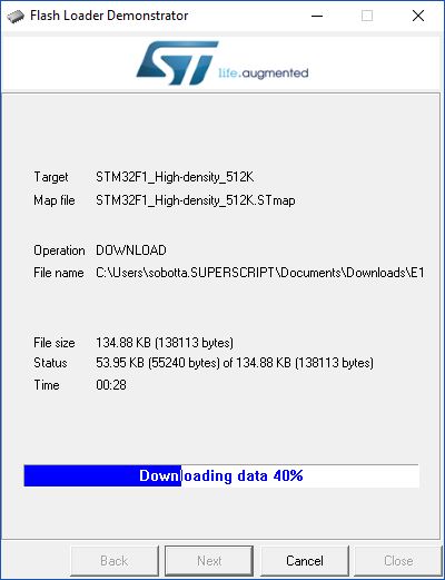

Your printer was running good since today. After instaling a print from the micro SD printing stops on regular printing after the first layers and I could not get him free. I could not see any reason on stopping. I try it again. the same thing but not at the same position. I want to load a new Firmware 1.11but I try several time. No firmware was loading. Jumper correct, reset , the Prosses was lik it is written above. the printer info shows no numbers and firmware information. Nthing happend on switching on.
Target: STM32F1_High-density_512K
Download fro file:E180_APP_M_V1.13.13.bin @ 8006000
E180_APP_S_V1.13.13.bin @ 8002000
Downloading File Sice 134.88 KB
There is no reaction
Can you help me
Greetings Christoph
Can you help me
Greetings Christoph
