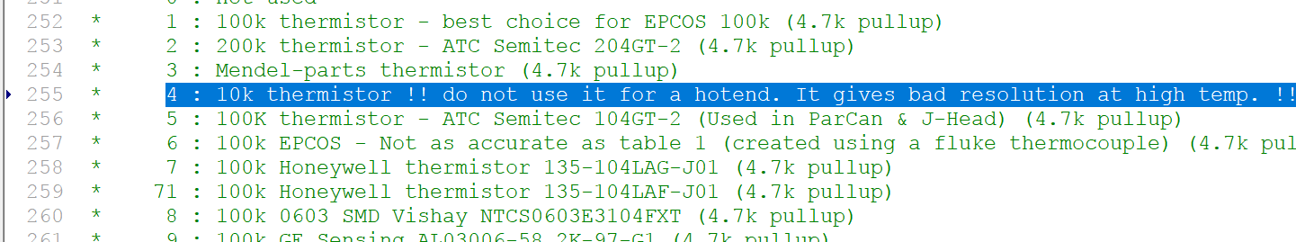

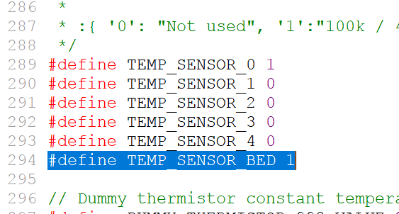

Re: Use Geeetech Superplate 3D Printer Aluminum Heatbed Kit with a Geeetech Prusa i 3 Pro B
You should change this line
You have misunderstood my meaning, I just tell you that you should change this line, the specific value you need to refer to these lines in your firmware
