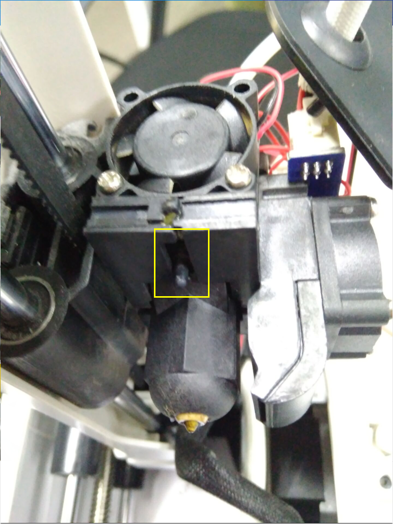

Re: Problems I am having with the E180
You can refer to it

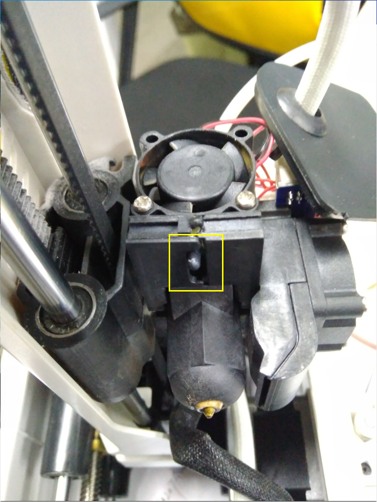

Joined: Tue Jan 16, 2018 8:47 am
Post by sectorbob »
hmm yours has a little nub or button? mine has a screw thread.. I wound up taking the whole print head assembly apart to change the removable head.. annoying but not too hard. Not liking the fact it is impossible to just replace the brass head. How much to replacement heads cost? how long for them to ship?
