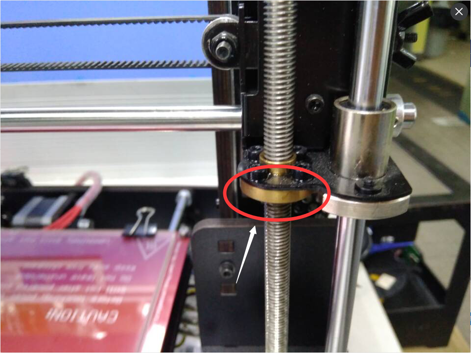

Re: Z axis not stepping correctly
I have a tip to adjust the brass nut.
You can send the AUTO HOME command first, and then wait for it to return to the origin, when it runs finished you can judge the number of lefts and right screw thread, and then adjust it.
Then you can make the height of the Z axis rise to half the maximum print high via LCD display control, the second time to send AUTO HOME instruction, through this method.
1.You can keep left and right relatively level around
2.You can get the result whether the pitch of left and the right threaded rod is about the same.
