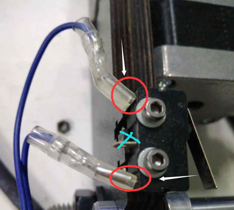

1.You should check the wiring of Endstop is correct
