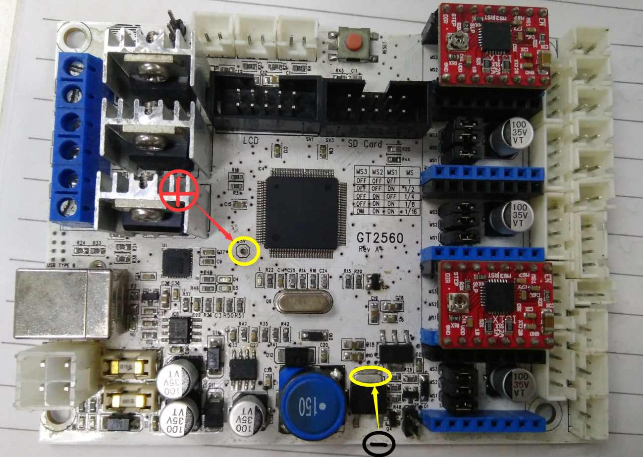

Have you tried to check the wiring of LCD and SD Card cables?
If you have tried it.I think you can refer to this picture

Thank you William. I have checked that it is connected correctly. What is the photograph showing me?
The printer works ok by usb connection but the lcd display does not work.
Re: Geeetech black acrylic 13 pro B display problem
If the voltage of it is normal 5V then you can know the issue is cables or LCD itself

Hi William
I have checked the voltage and I am getting 5 volts. I have also checked the leads for continuity and they are both okay. How do I go about getting the LCD replaced?
