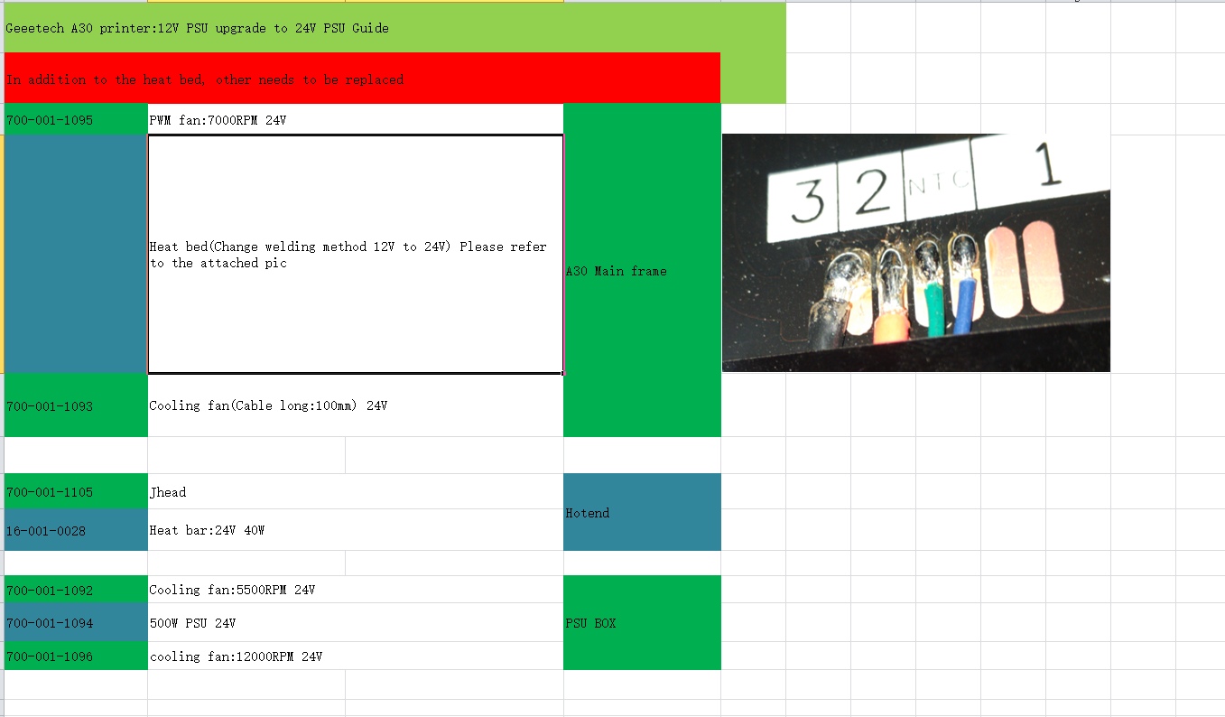

If I was to upgrade my existing 12V 15A Geeetech PSU to a 24V 20A PSU, am I right in thinking that all I would need to do is to just plug it straight into my GT2560A+ board using exactly the same cable configuration - then change the soldered cable connection to the hotbed from the 12V to the 24V connection that's next to it?
Is it really that simple?
Re: 24v PSU upgrade
You can upgrade 12V PSU to 24V,don't need change anything

I have read somewhere that A30 psu corrently is 12V but soon to be upgrade to 24V.
May we update the 12V PSU to 24V just plug and play or we will need to do changes ?? thanks

Refer to this pic
A30-12V PSU Upgrade To 24V PSU.png (211.61 KiB) Viewed 26397 times
