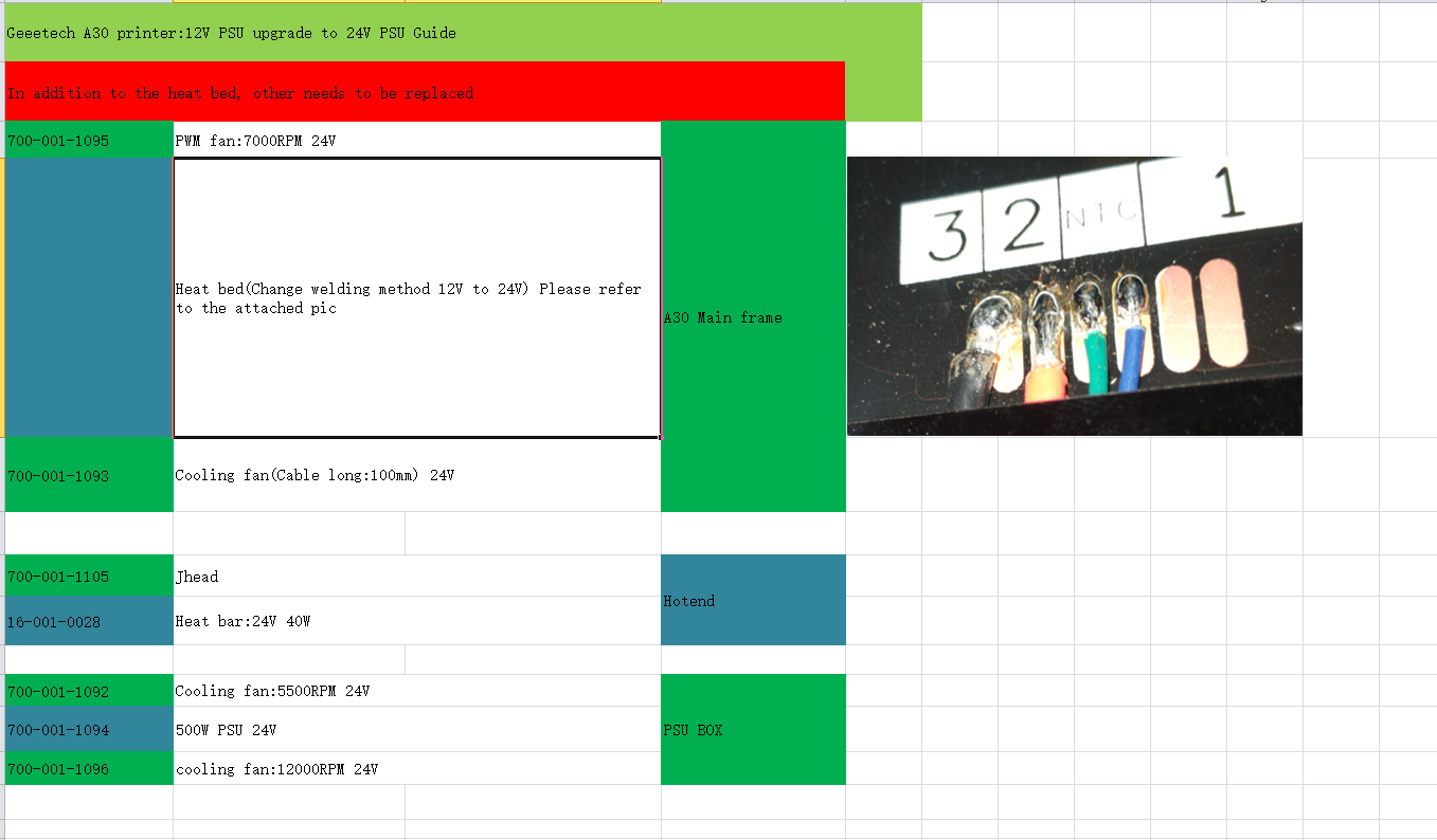

I have read somewhere that A30 psu corrently is 12V but soon to be upgrade to 24V.
May we update the 12V PSU to 24V just plug and play or we will need to do changes ?? thanks
Re: 24v PSU upgrade
Posted: Thu Aug 23, 2018 10:46 am
by Admin
Refer to this pic
