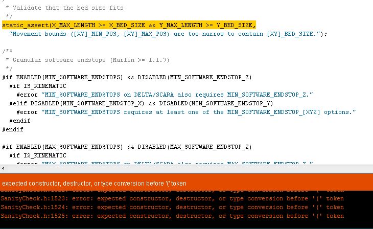

Hi to all, i mtry to flash the 1.1.8 bltouch t8screws firmware but during convalidate in arduino, appear this error message.. i know its about the bed measure..but i don t know how to do now,......
please,can someone help me for this?
thank again for all the works.

You must select the correct board... go to "tools" --> "board" --> Mega2560

I have the same issue at this line and I have the correct board. anyone knows what happens?
