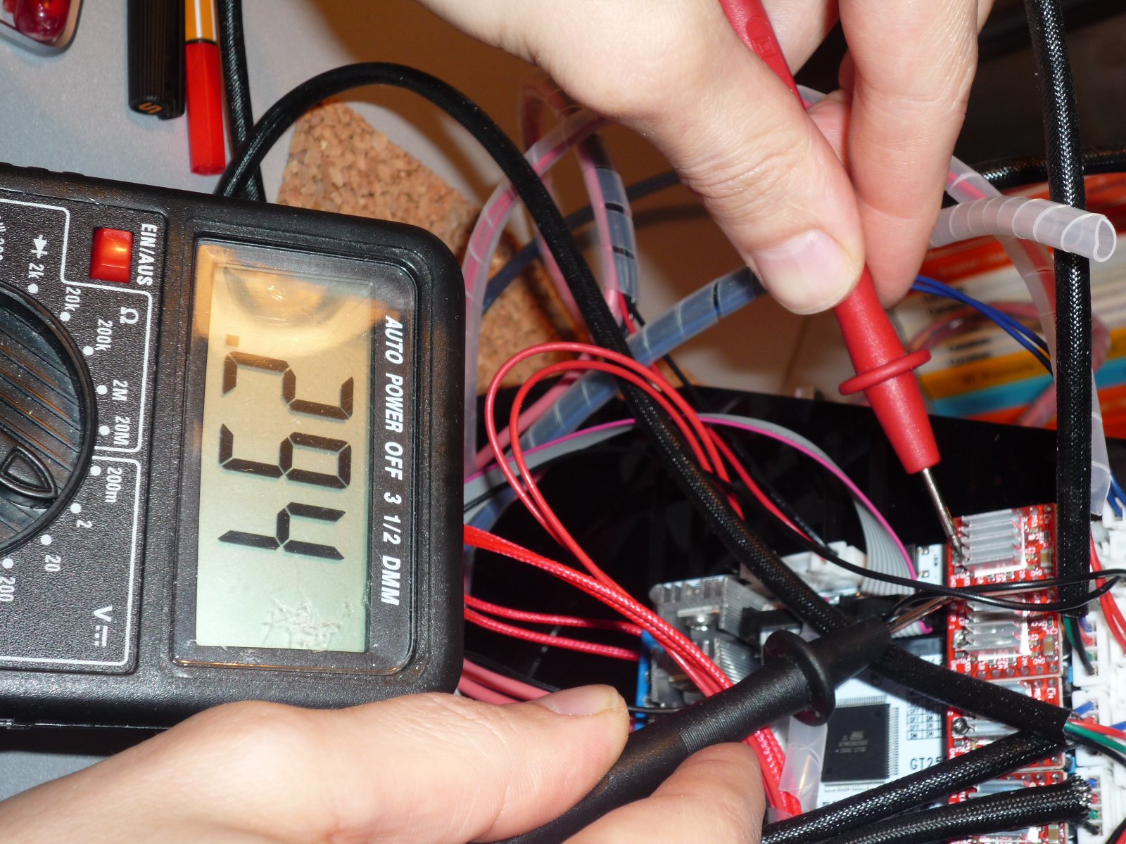

2. I measured the voltage at the stepper driver and get only 0.3V at each driver (power supply at the PSU is with 12V OK) and it is not possible to increase the voltage by turning the potentiometer
Stepper motor moving in one direction
- P1100614.JPG (399 KiB) Viewed 9270 times

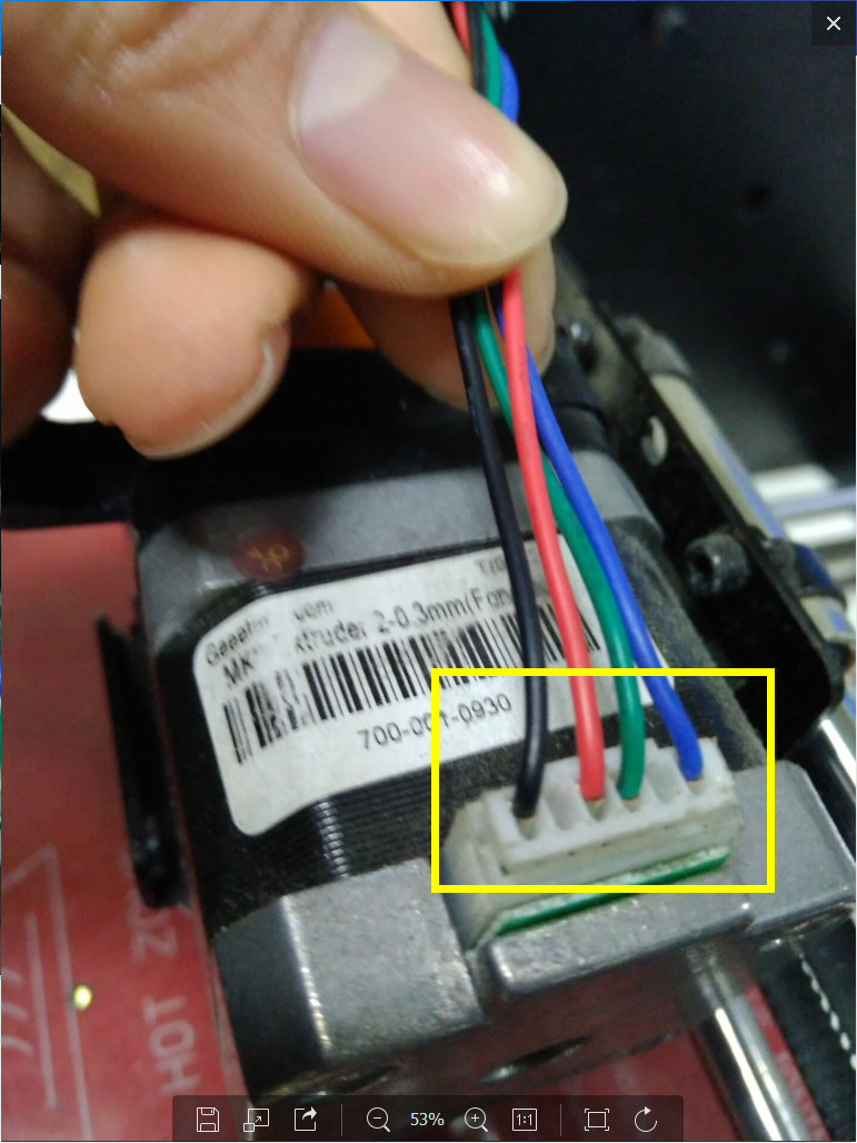

And did you check the correct order of wires in the motor connector?
William, my friend, show a colleague the photo. Let him check if everything is properly folded.
kaktus
kaktus
Re: Stepper motor moving in one direction
Hi ,you can refer to this pic

of course I (double) checked the wiring and all was fine. However, I realized that the stepper driver of my extruder was delivering the 0.8V (didn't check it in the first place, because i was focusing on the axis). After I replaced this one with one of the axis, the axis was working fine. So I ordered a couple of new stepper drivers and now everything is working.
Bottom Line: 3 of 4 stepper driver of my brand new Prusa were not really broke, but didn't get the requested voltage and as a result the stepper motors were only turning in one direction.
