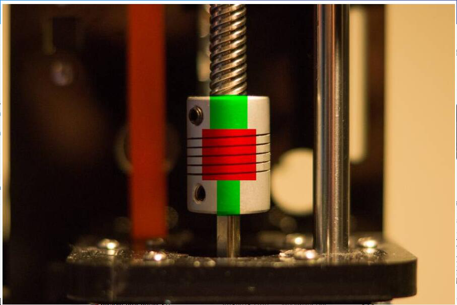

2. Please tighten the screws of the coupling. The correct mount way:

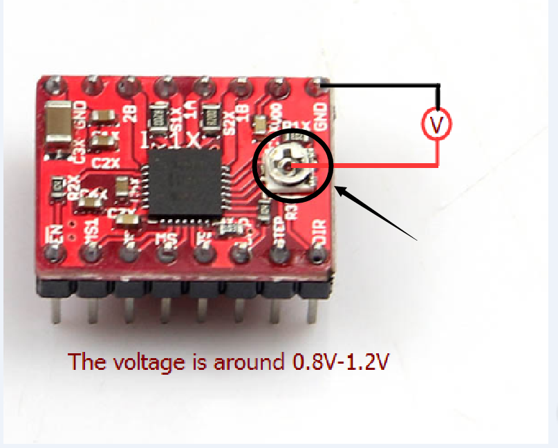

4. Maybe the A4988 of Z-axis has not enough power to drive the motor. And you should increase the voltage of A4988. you can refer to this post.
http://www.geeetech.com/forum/viewtopic ... 7&t=17038

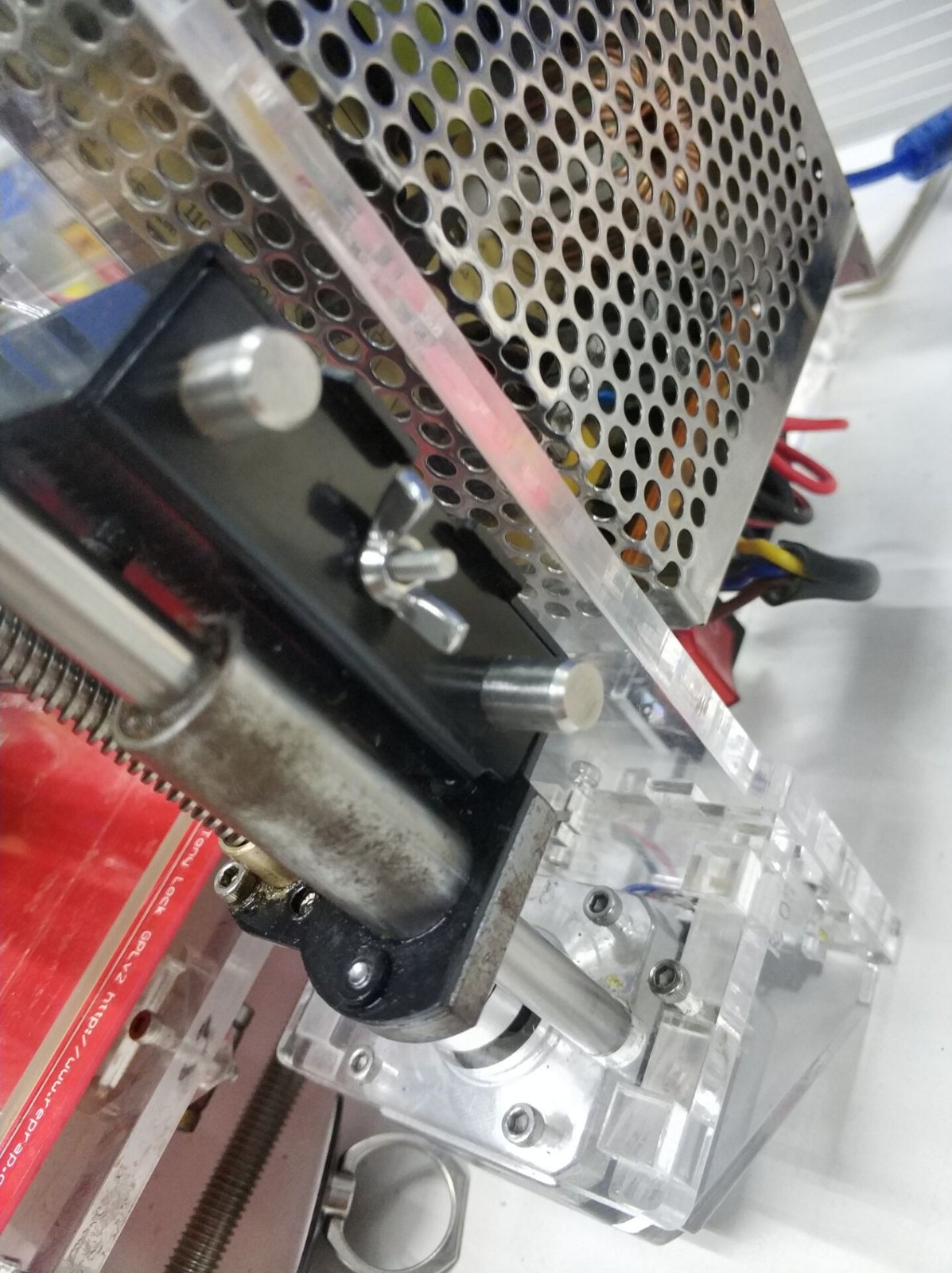

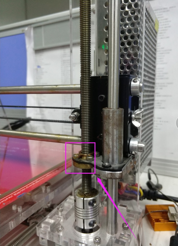

5. You should loose the Z brass nut a little.

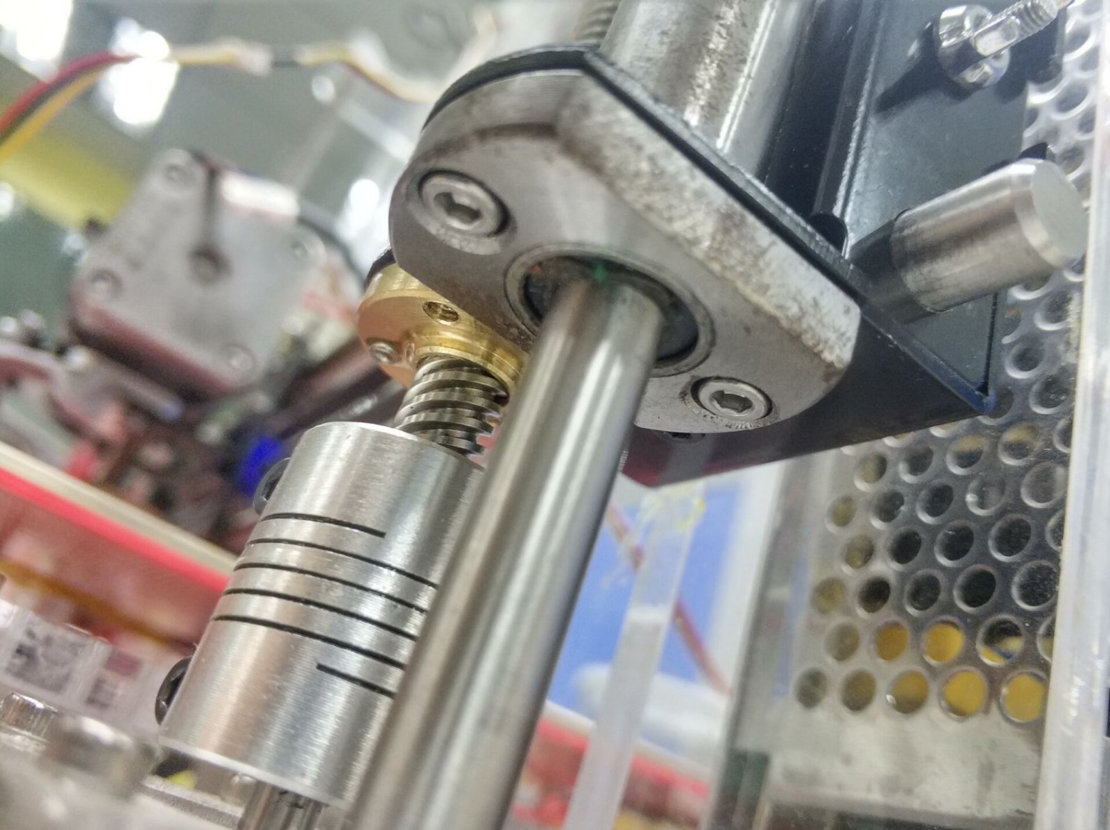

6. Check this area(Linear Bearing:LMH8LUU)
Please do not tighten the screws too tightly

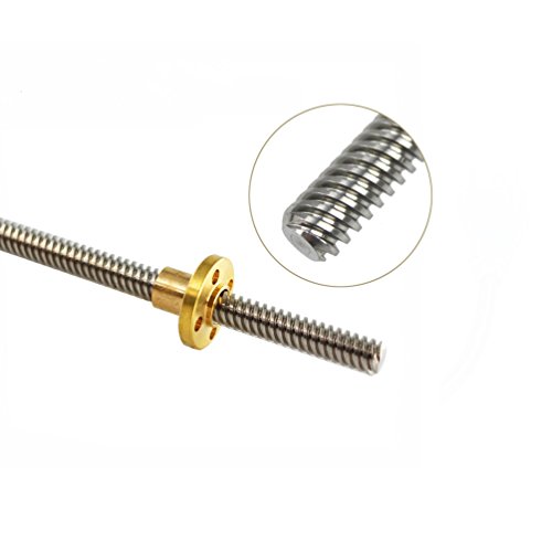

7. Check the thread rod type of Z axis
For T8 rod.You can send Gcode"M92 Z400" and then send"M500" to save the setting
For M8 rod. You can upload the official firmware directly

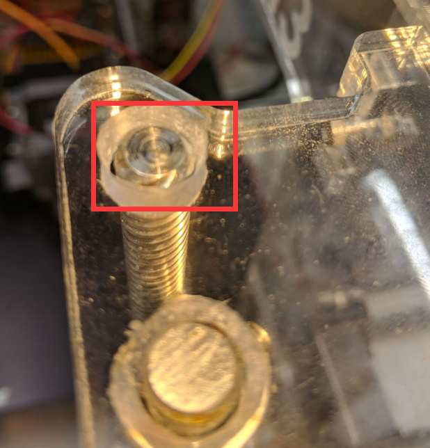

8.You can use a file to polish this hole in the i3-08 part

if you losen the "yellow" nut would that not cause Z axis wobble?
