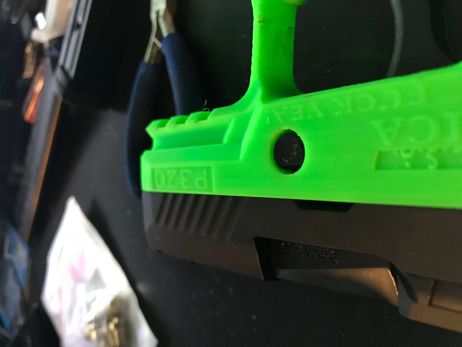

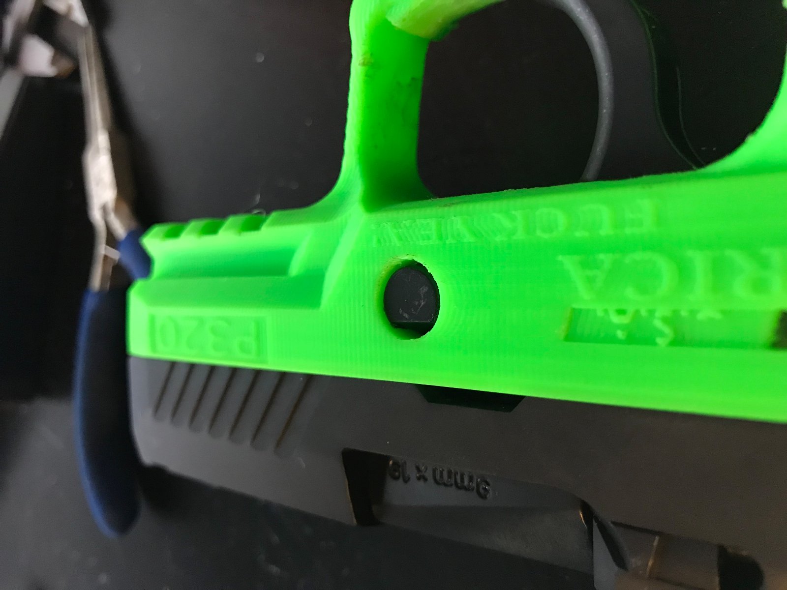

I have a simulator issue when printing in.1mm i get a wave in the outline shown in the attachments? It a very small ripple along some parts.
- IMG_7062.jpg (184.07 KiB) Viewed 10691 times
- IMG_7060.jpg (185.19 KiB) Viewed 10691 times
