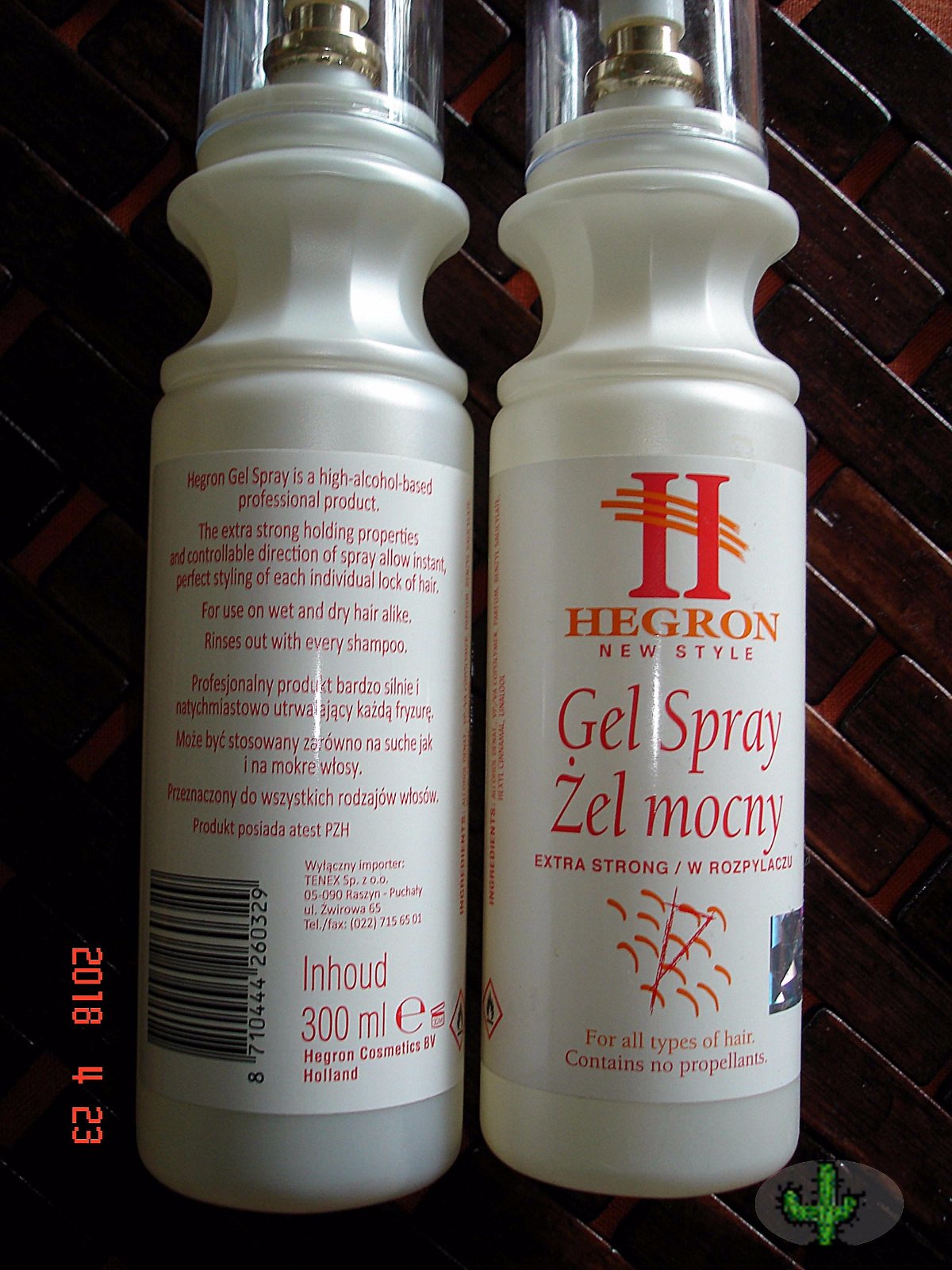

I use something that nobody has come up with here ;-)
[attachment=0]lakier_do_wlosow.jpg[/attachment]
The cost is small, the effectiveness of good, smells good, it is easy to wash off with clean water. ;-D
- hair spray
- lakier_do_wlosow.jpg (299.75 KiB) Viewed 7277 times
