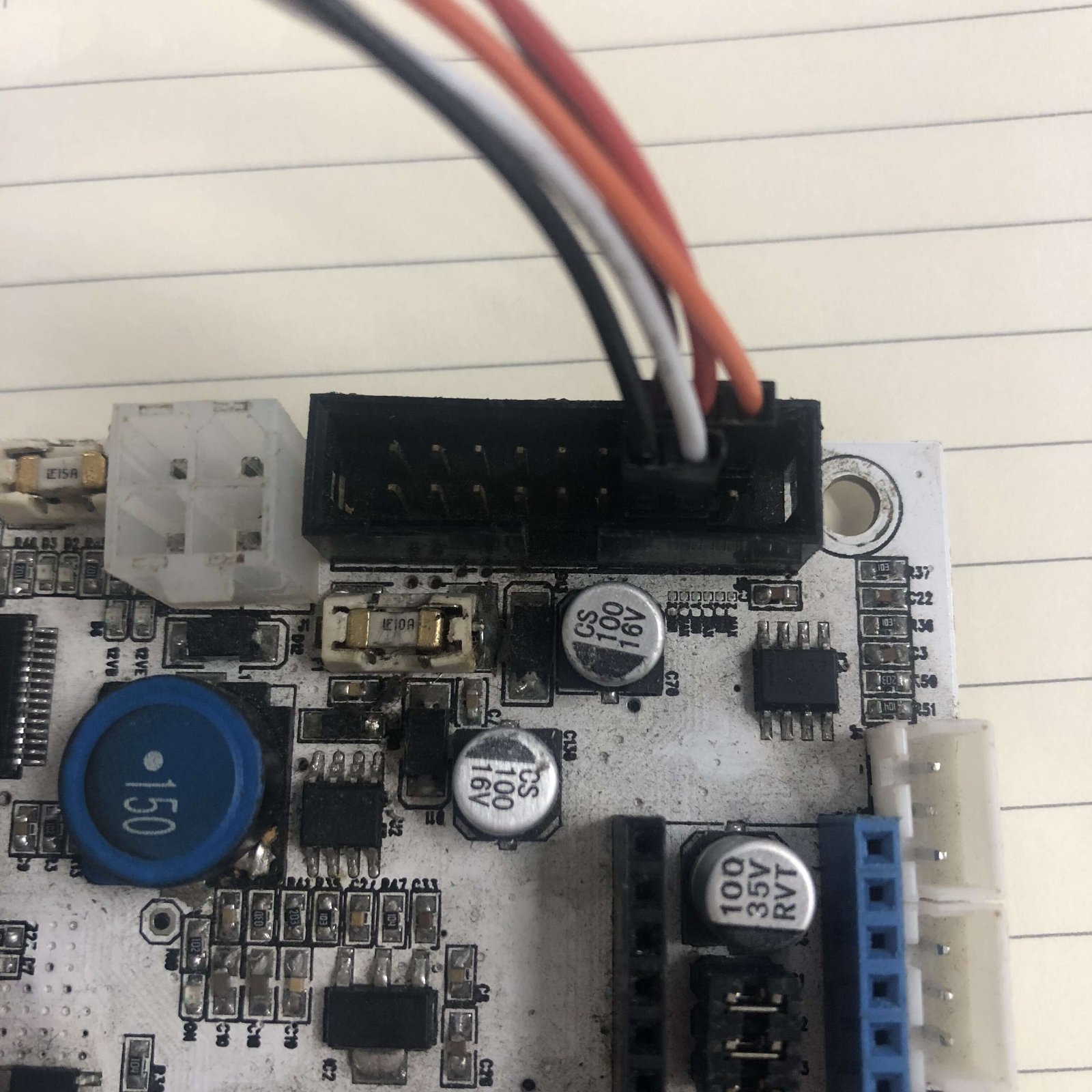

Hi all where i can find Wiki for this main board?
[attachment=0]board.jpg[/attachment]
i need it for find Zmin and Zmax pin for connect 3d Touch Auto levelling sensor...
Please help me

You can see the mark near the slot.
The 3D Touch should be wired like this.
GT2560 RevB+3D Touch.jpg (323.11 KiB) Viewed 33139 times
