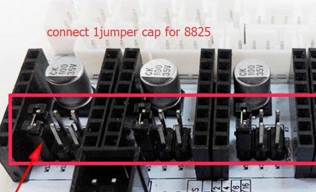

I have left all 3 jumpers under each DRV8825 in place as i want to run at 1/32, and for X & Y axis this works fine but i can't get the Z axis to run at all, i did read somewhere that you remove all but one jumper and still have 1/32 stepping but cant find the page now or remember which jumper to leave in place?

Did you solve the issue?
I think the message you mentioned is as follow, from the post:
viewtopic.php?f=17&t=17038
- 8825.jpg (221.16 KiB) Viewed 4995 times
