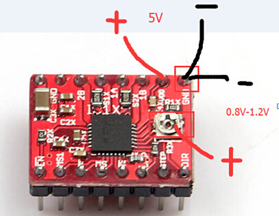

1, I think you might check the wirings of endstops first.jcsmar wrote: Sat Jun 09, 2018 4:08 pm hi all
first time user of 3d printers maybe i should have gotten a less complicated one. i had a problem with the limit switches and lined up with the motors, it all went up to home however i still had one side stopping short.
today all drives drove the head up all switches activated but motor still working?
and i cant get the head to move down at all now. I have used both software EasyPrint3D and Repetier and still the head does not go down it keeps going up.
can anyone explain how to change the voltage i read about this problem however there are no details on how to do it.
well any assistance would be great..
John
2, If wirings are OK, you can try to change the settings of motor direction with LCD->Control->Print Setting->X/Y/Z DIR
3, You can search in forum about how to adjust the voltage of driver.
- driver voltage.jpg (146.16 KiB) Viewed 15123 times
