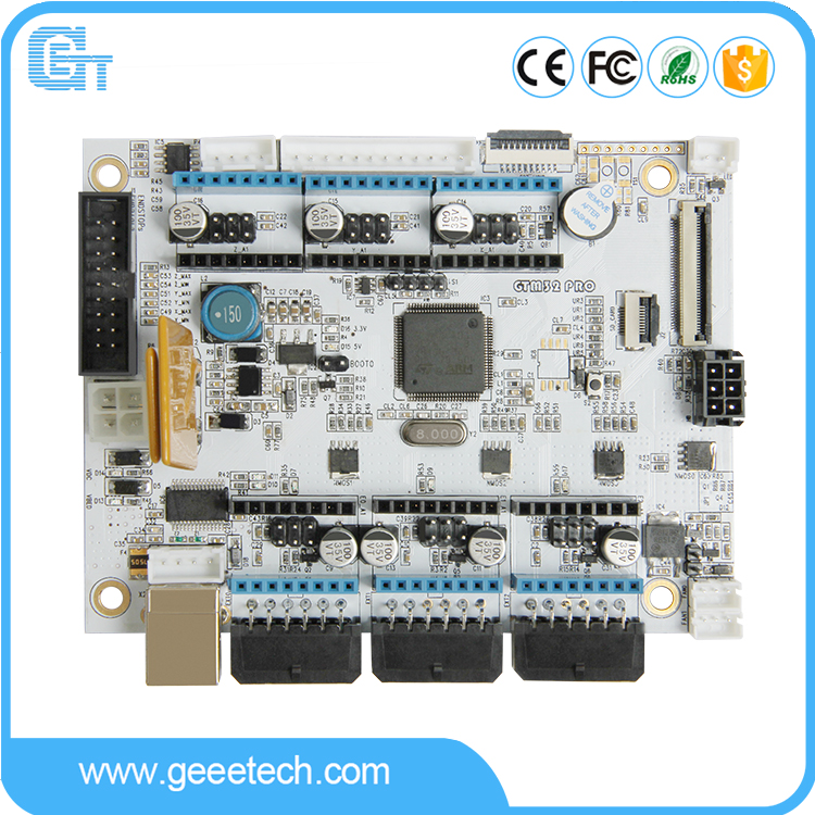

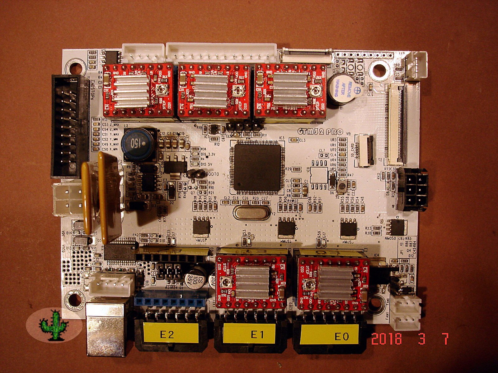

Hi dave m.
The fundamental difference is the main microcontroller from another family.
GT motherboards are equipped with AVR 8-bit - ATmega 2560.
https://www.microchip.com/wwwproducts/en/ATmega2560
GTM motherboards, specifically GTM32 Pro vB, feature Cortex M3 32-bit STM32F103VET6.
http://www.st.com/en/microcontrollers/stm32f103ve.html
These are logical systems of a completely different class.
Photographs to watch:
[attachment=2]GTM32vA&vB.jpg[/attachment]
[attachment=1]IMG_9002.png[/attachment]
[attachment=0]GTM32Pro_vB.jpg[/attachment]
Unfortunately, I don't have any images of the GT2560 that I could boast of. But I think you have it ;-)

Thanks `kaktus` that solves a few problems.......... Dave M.
