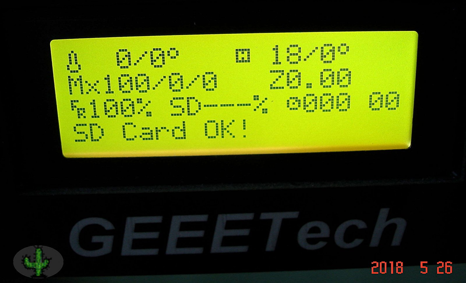

I guess the users of this printer model have not received such manual and maybe they will be happy now.
Here are the results of my work:
Menu-tree for the DELTA Rostock 301 printer, with firmware version 1.0.04, per day 2018-05-25

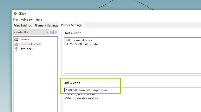

Btw. why in the new FW v1.0.04 suddenly my Rostock 301 extrudes Filament after my printjob end. I have no option to switch that off!
I dont want that.
I dont want that.
Re: kaktus' guide - Menu-tree Rostock 301, FW v1.0.04
I think you could add end Gcode in slicer software to turn off nozzle and bed heating:MarcusMGT wrote: Mon Jun 11, 2018 1:35 am Thanks for the info. I was in the firmware section, but cant find this FW v1.0.04 anywhere. The only way to get it was via easyprint software from Geeetech.
I dont want that.
M104 S0 ; turn off nozzle temperature
M140 S0 ; turn off bed temperature
When colling down, filament can stop coming out.
- M104 S0.jpg (28.65 KiB) Viewed 46142 times

Info screen.
Basically, it's the main screen. Its content is visible immediately after switching on the printer's power supply.
The first line:
- After pressing the encoder button, the level 1 menu is started.
- Rotating the trigger knob directly changes the responsible value of the printer's operating speed. This way you can increase or decrease the print speed.
Changes can be made during the printing process.
The first line:
- contains information about the temperature reached and set for the head (hot end) and the heated work table (heat bed).
On the left side the information for the head on the right side of the work table is displayed.
e.g.
18/0° - means current temperature 18°C, setpoint temperature 0°C.
A zero value for the setpoint temperature means that heating is deactivated.
A zero value for the sensor display indicates that the temperature is not measured. It may be caused by sensor damage or a failure to contact.
exception: this can happen up to a few seconds after the power supply has been switched on.
- contains information about the ratio of mixing of the material (Mx) and about the current position of the Z-axis mechanism (Z-axis coordinate).
On the left is the information about the set mixing factor of the material, on the right is the current Z axis coordinate.
e.g.
Mx 96/2/2 - means that 98% of the material will be taken from the first extruder and 2% from the second extruder and 2% from the third extruder.
None of the values should be set to 0, which may cause the feeder tube to clog in the head.
The setting is designed for mixing colours.
Z0.00 means that the head nozzle is at a height of 0.00mm above the work table.
- contains information about the speed of the printer's operation, the progress of the printout started from the SD card, the time that has elapsed since the power supply to the printer was switched on.
On the left is the information about the currently set speed coefficient of the printer (FR - frame rate?).
The middle of the line contains information about the printing progress from the SD card.
The right part of the line shows the operating time of the printer.
e.g.
FR100% means operation (printing) at standard speed. A value of less than 100 indicates slowdown, a value of more than 100 indicates that the printer will work faster. You can set the value from the range of 15-300,
SD---% means that the functionality of printing from the memory card is not enabled,
000.00 means that the power supply to the printer has just been switched on.
- Information displayed - text.
You can use Gcode to display your own text.important: we have 20 characters available, including spaces, etc.Code: Select all
M117 drukara M201 kaktusa
As a standard, text is displayed when the power supply is switched on: "SD Card Removed!" when the memory card is not loaded.
If you plug in the SD card - before turning on the power, the presented content is as follows: "SD Card OK!".
This indicates that the card has been correctly detected by the printer's controller.
