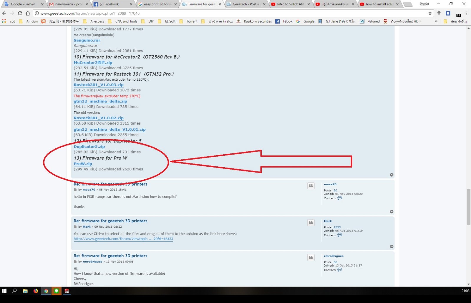

After upload firmware by arduino "firmware No.13".
After that, update again through the program "EasyPrint3D".
