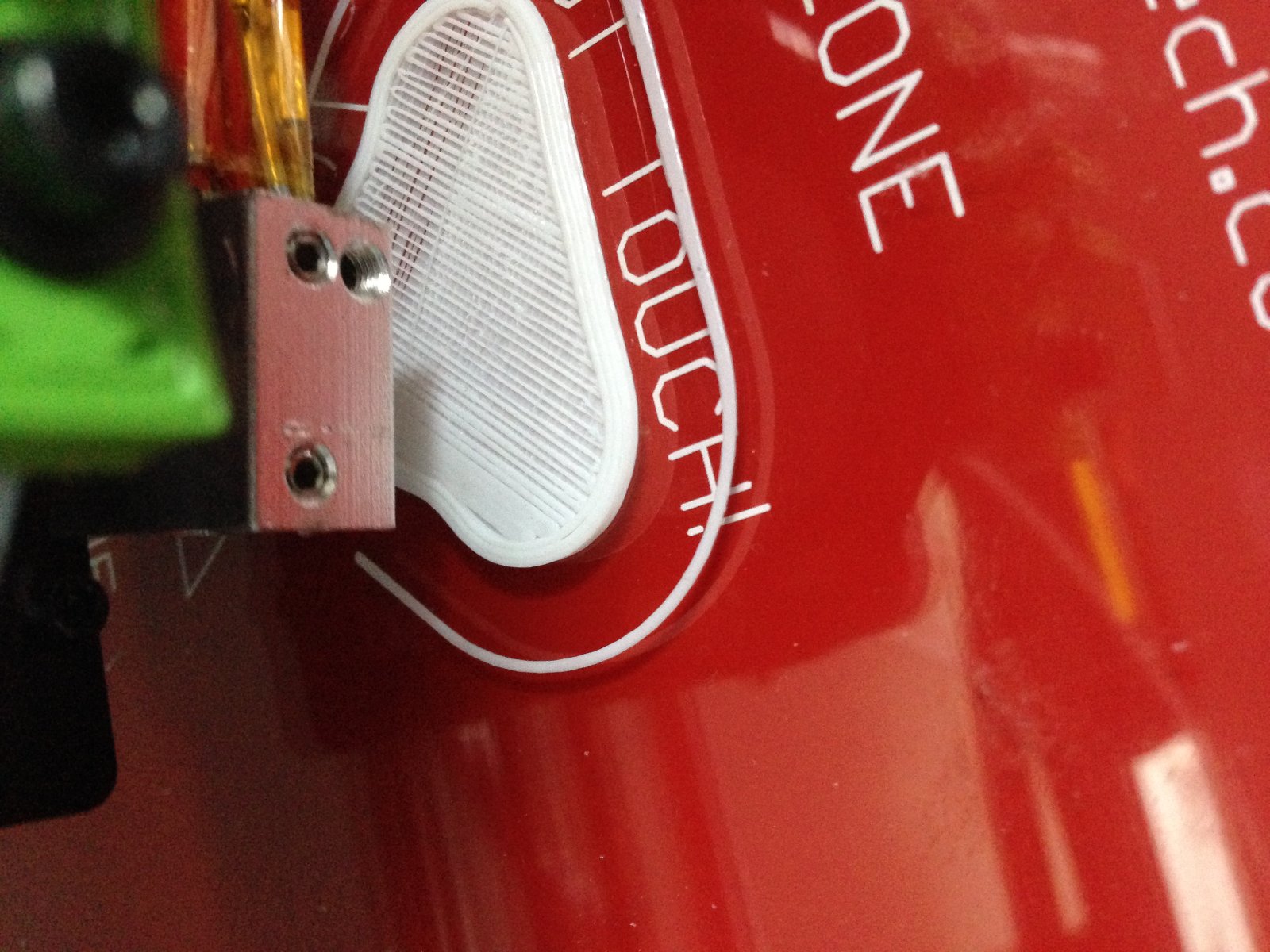

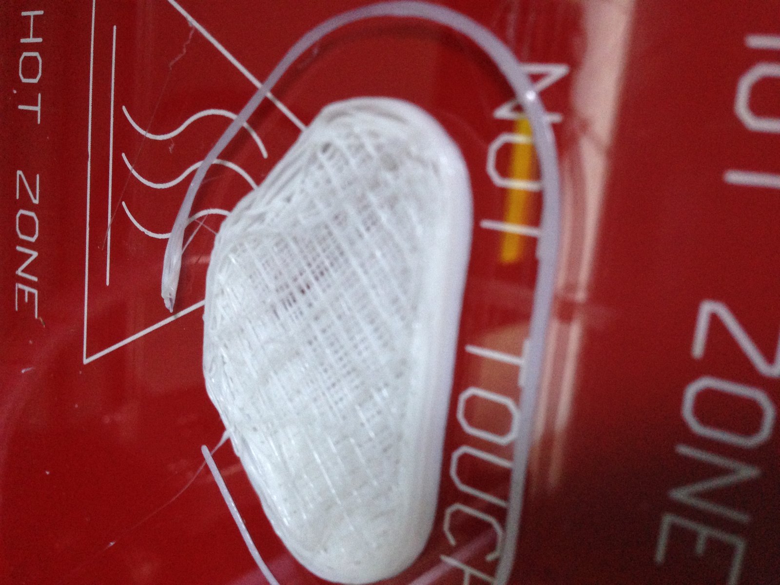

hi this problem affects all layers and i have slowed the first layer speed down and it has increased the print quality for the first 5 layers but when it starts on the infill it doesn't extrude properly.

This looks like your nozzle is too far away from the bed, check your bed leveling using the paper method or better still feeler gauge
