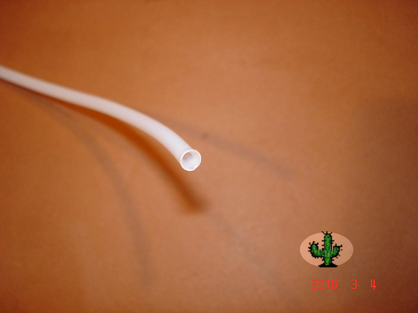

The first step is to cut off the inner edge of the tube with a very sharp pointed knife.
The tube is very smooth and hard, so be careful not to cut yourself.
view of the tubing after the procedure

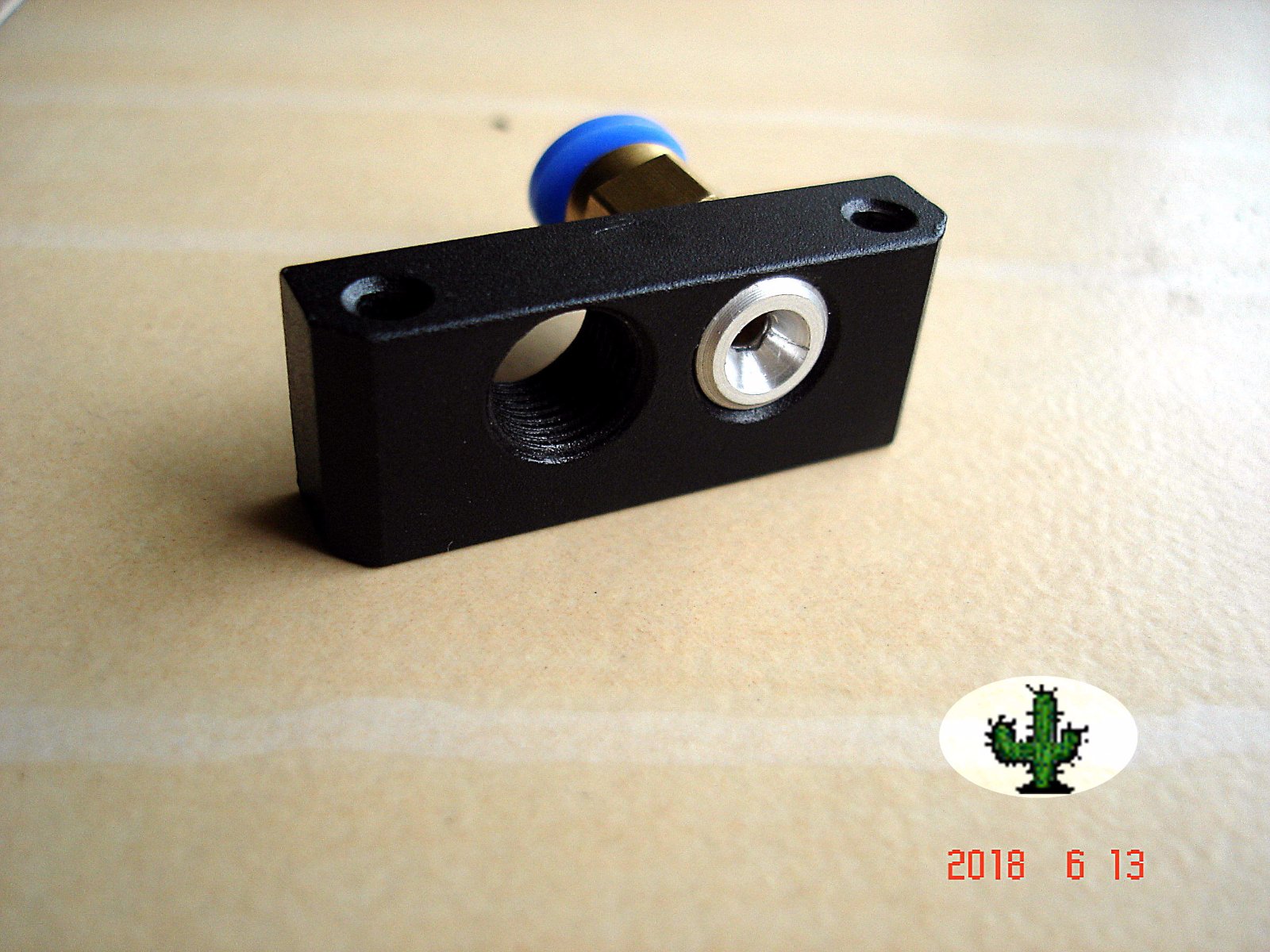

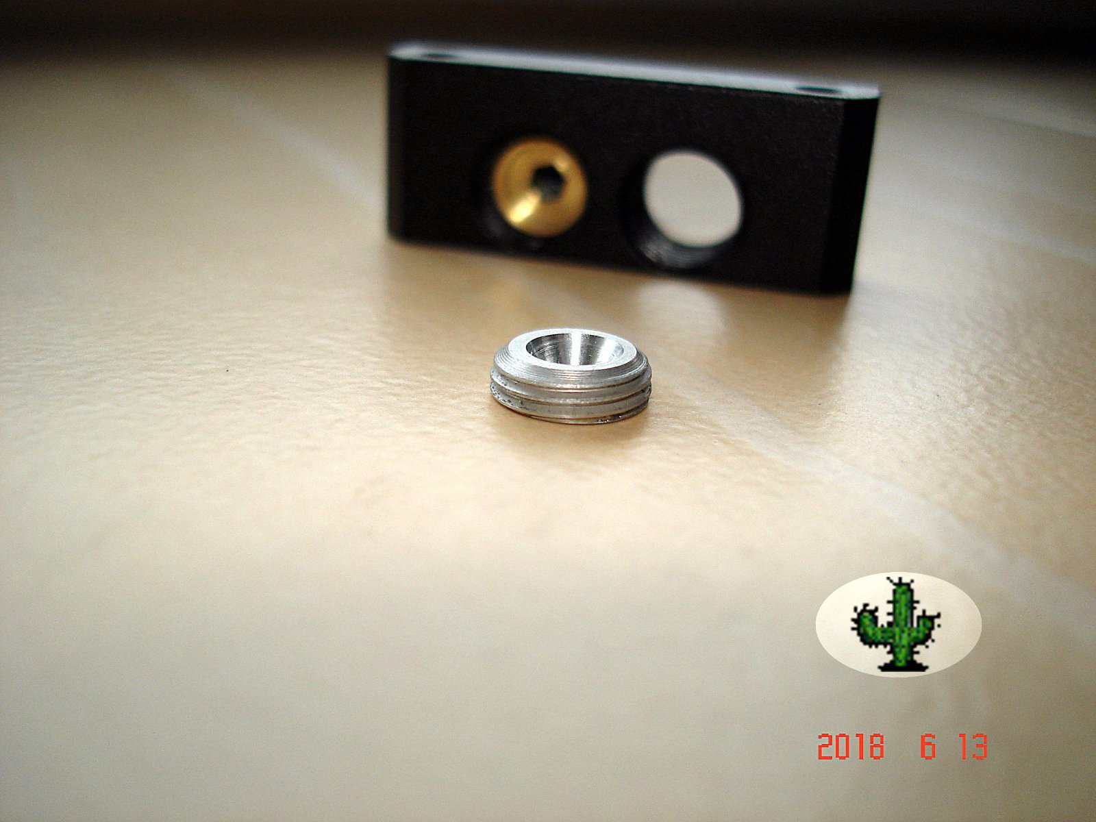

The next stopper is making an additional element to be placed in the bracket - pneumatic connector PC4-01.
I made it by cutting off the apex of the special screw.
prepared element.
prepared element.
This cut off piece of screw has a height of less than 3mm. It must all fit into the hole. It must not protrude out of it a little.
view after assembly
view after assembly

The person who loves details I would like to say that the screw which was used as an organ donor had an inch thread 1/8". ;)
It was an aluminium screw that a fellow man prepared for me on a lathe machine.
Since then, this simple modification has allowed me to easily and reliably load a new filament.
I recommend it to everyone.
