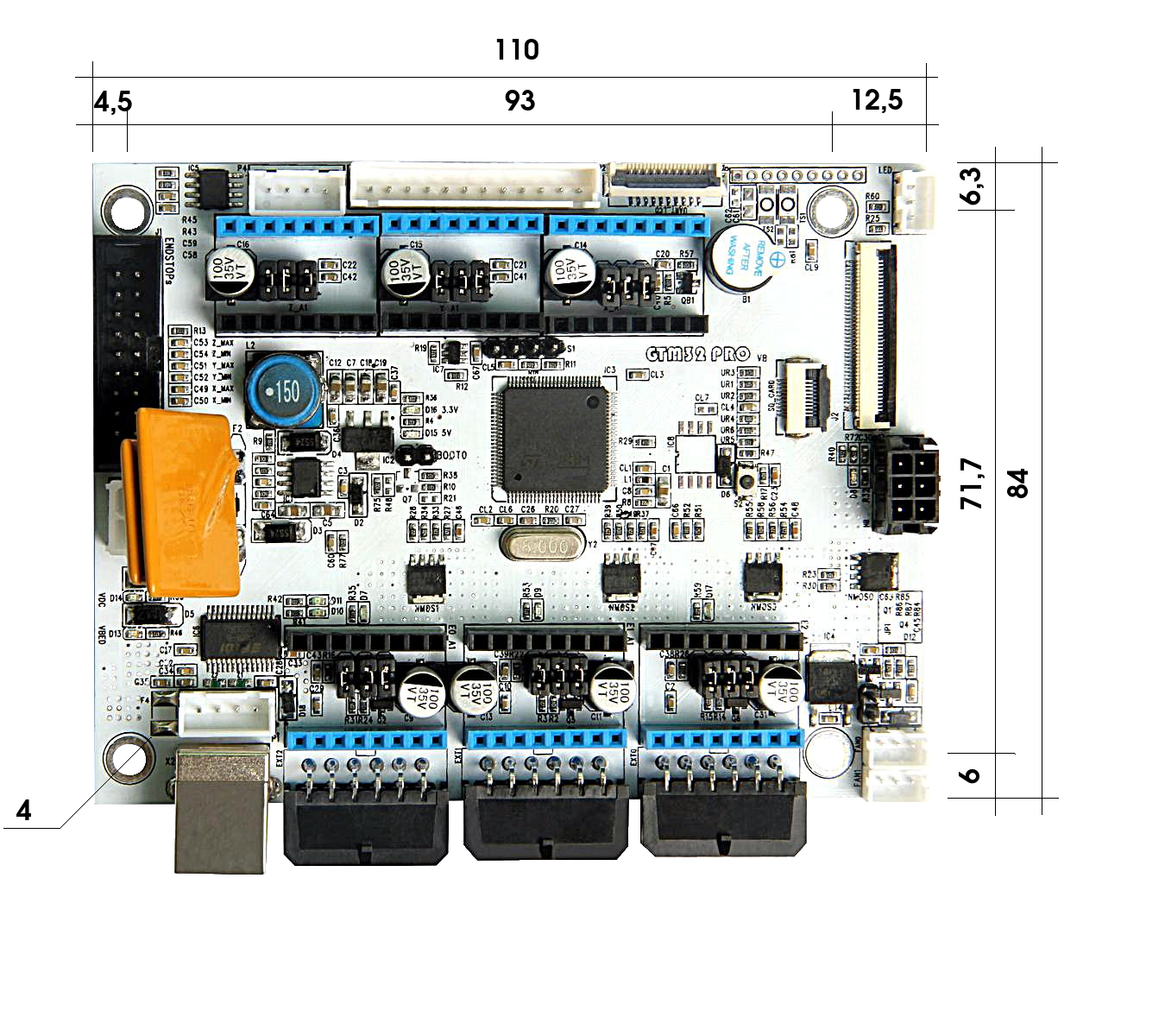

The Geeetech Prusa I3 M201 dual extruder mixcolor 3D printer is equipped with a GTM32Pro vB controller. The PCB is 84 x 110 mm in size. The mounting holes are arranged not symmetrically.
dimensioned image
dimensioned image

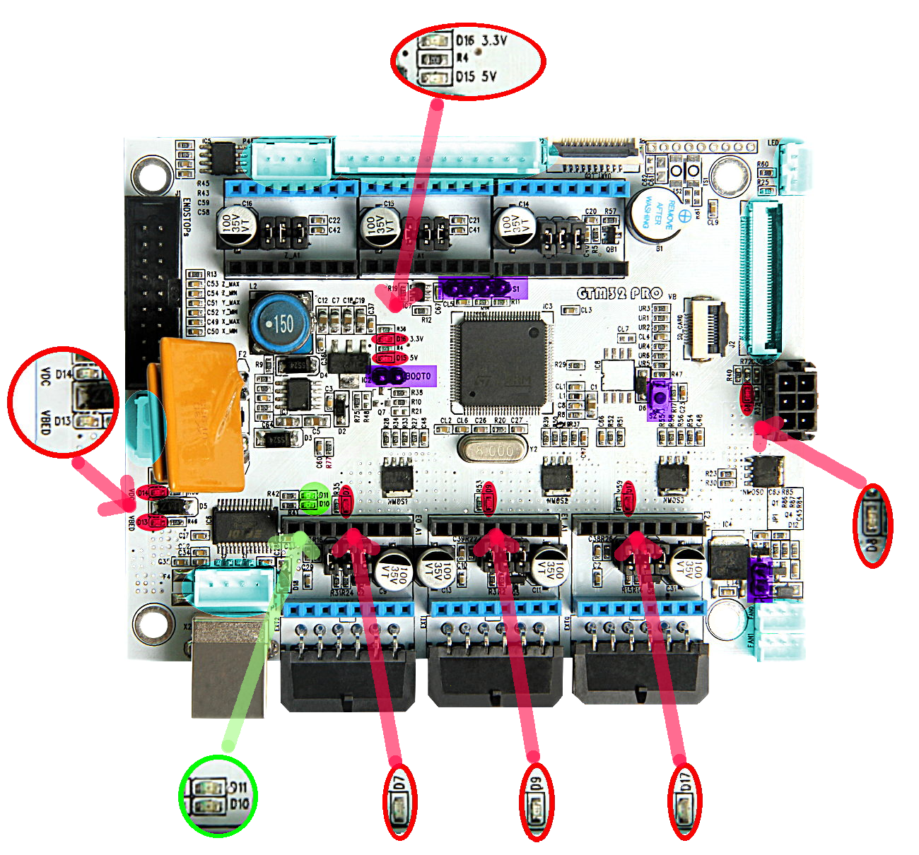

The controller is richly equipped with LEDs informing the user about the active power supply and current actions. ;)
LED indicators
LED indicators
The following LEDs indicate the power supply voltage at the main points of the system:
D14 - VDC, red, indicates the presence of 24V0 DC master supply voltage
Correct condition - Lights up intensively,
D13 - VBED, red, indicates the presence of 24V0 DC supply voltage for the work bench heater (Hot Bed)
D15 - VCC 5V, red, indicates the presence of voltage 5V0 DC for control electronics, with current capacity up to 3A
D16 - VCC 3V3, red, indicates the presence of 3V3 DC voltage for the control electronics, with current capacity up to 1A
If all LEDs are off, the printer’s power is off or the 24V DC power supply has failed, if one of the LEDs is off, the printer has a defect.
As a rule, the LEDs D14 VDC, D13 VBED, D15 VCC 5V, D16 VCC 3V3, D7 will light up after the printer is switched on and after each reset, and then the LED D7 will turn off after about a second.
The following LEDs indicate the work progress:
D10 - RS, green, indicates ongoing communication on the TxD line of the RS interface (target USB port)
Correct state - flashes very quickly or is extinguished in case of lack of communication,
D11 - RS, green, informs about ongoing communication on the RxD line of the RS interface (source USB port)
Correct state: blinks very quickly or is extinguished in case of lack of communication,
D7 - red, indicates that the bootloader is activated
Correct condition: Not lit - Normal operation of the printer,
lights up solidly, the bootloader has been activated to update the printer's firmware,
D8 - HOTBED, red, indicates the current operating status of the work bench heater
Correct condition: it is off - heating is off,
lights up intensively - the heater operates at full power,
flashes quickly, slowly or periodically - limiting or activating the full power of the heater,
D9 - HOTEND1, red, indicates the current operating status of the second printer head heater (Hot End1), Not used…
blinks quickly slowly or periodically - limiting or activating the full power of the heater,
D17 - HOTEND0, red, indicates the current operating status of the first/major printer head heater (Hot End0),
blinks quickly slowly or periodically - limiting or activating the full power of the heater.
