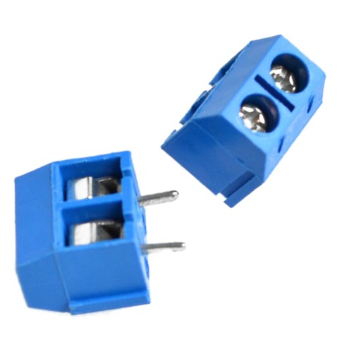

Post by _kaktus_ »
:mrgreen:
A very good solution has been found for my printer.
This is the ARK screw socket.
This socket is very versatile and reliable.
And it does not pose any problems when it comes to replacing the connected periphery.
:D
