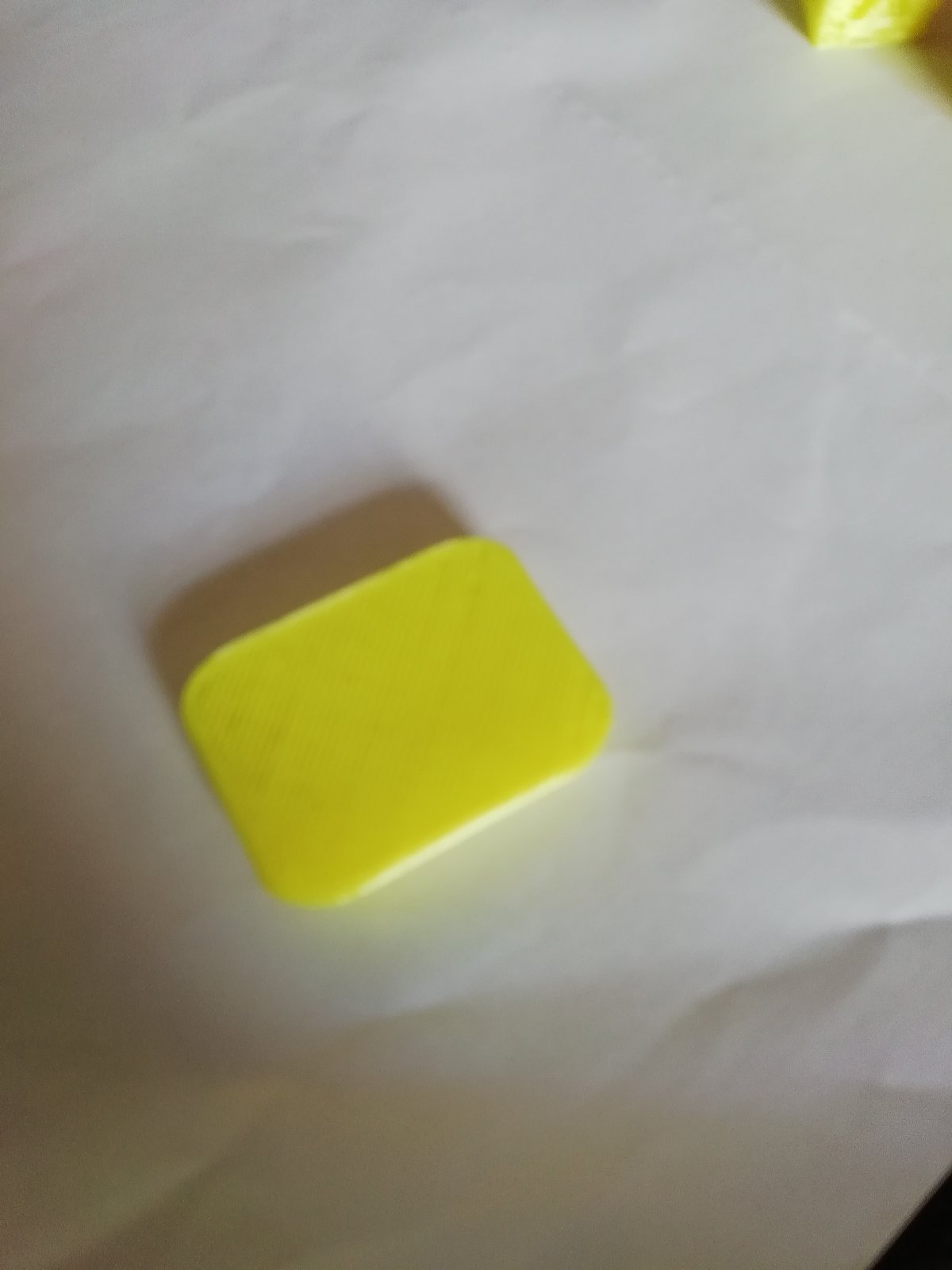

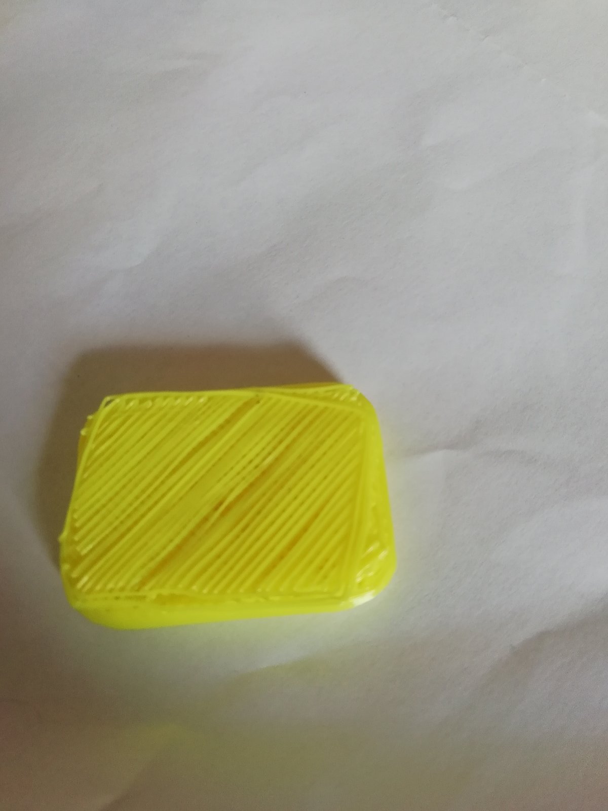

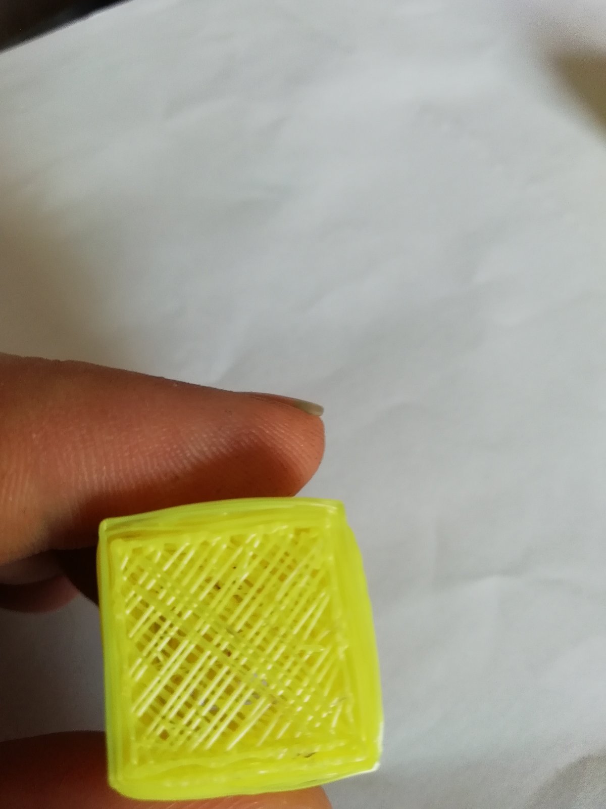

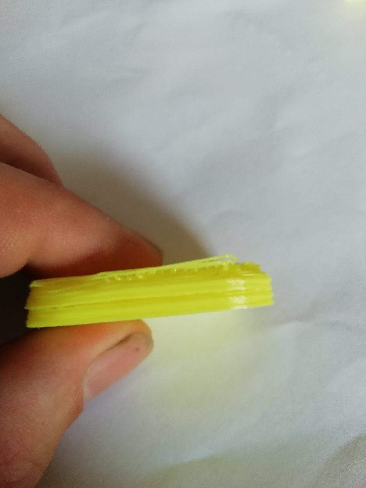

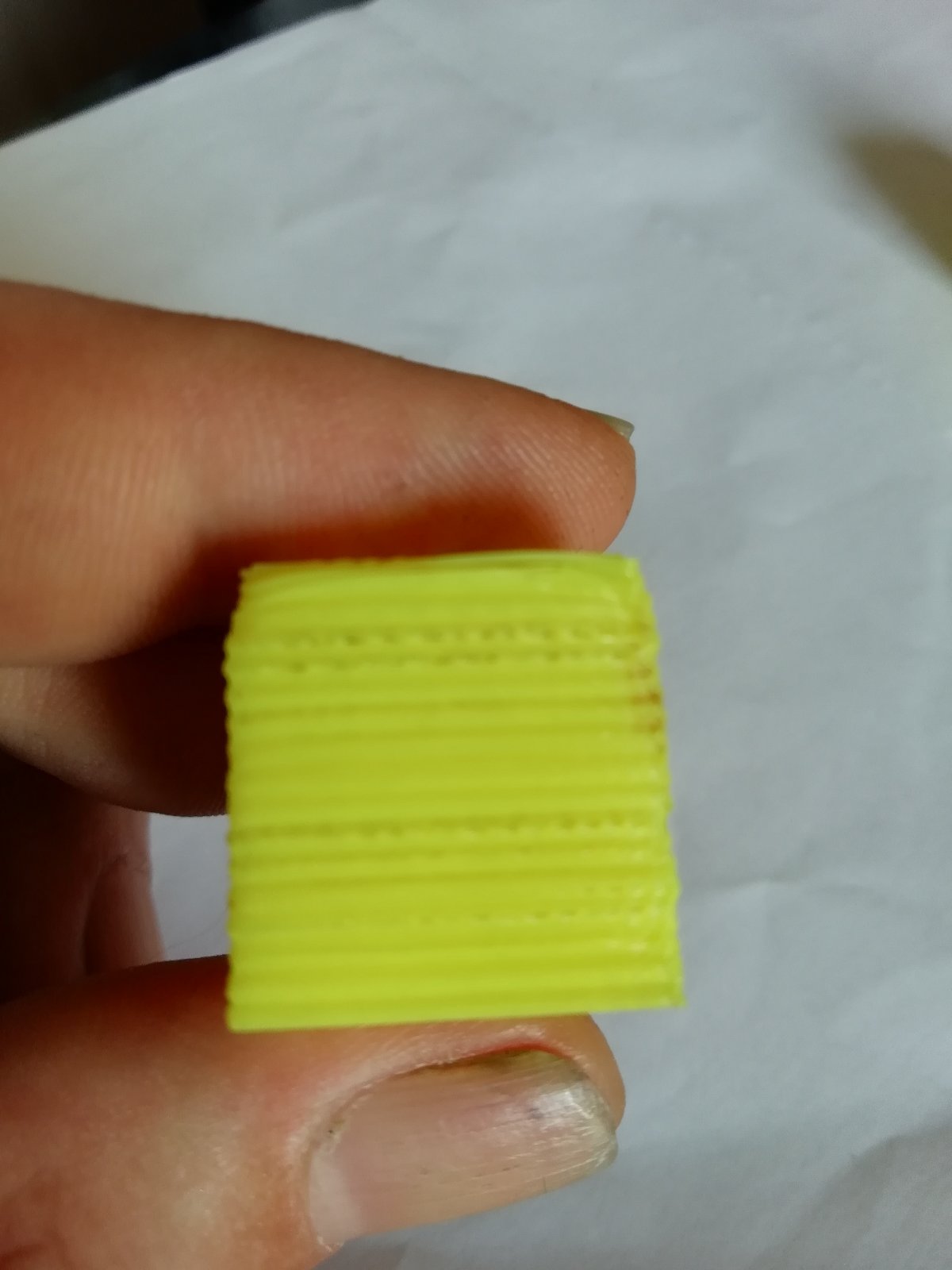

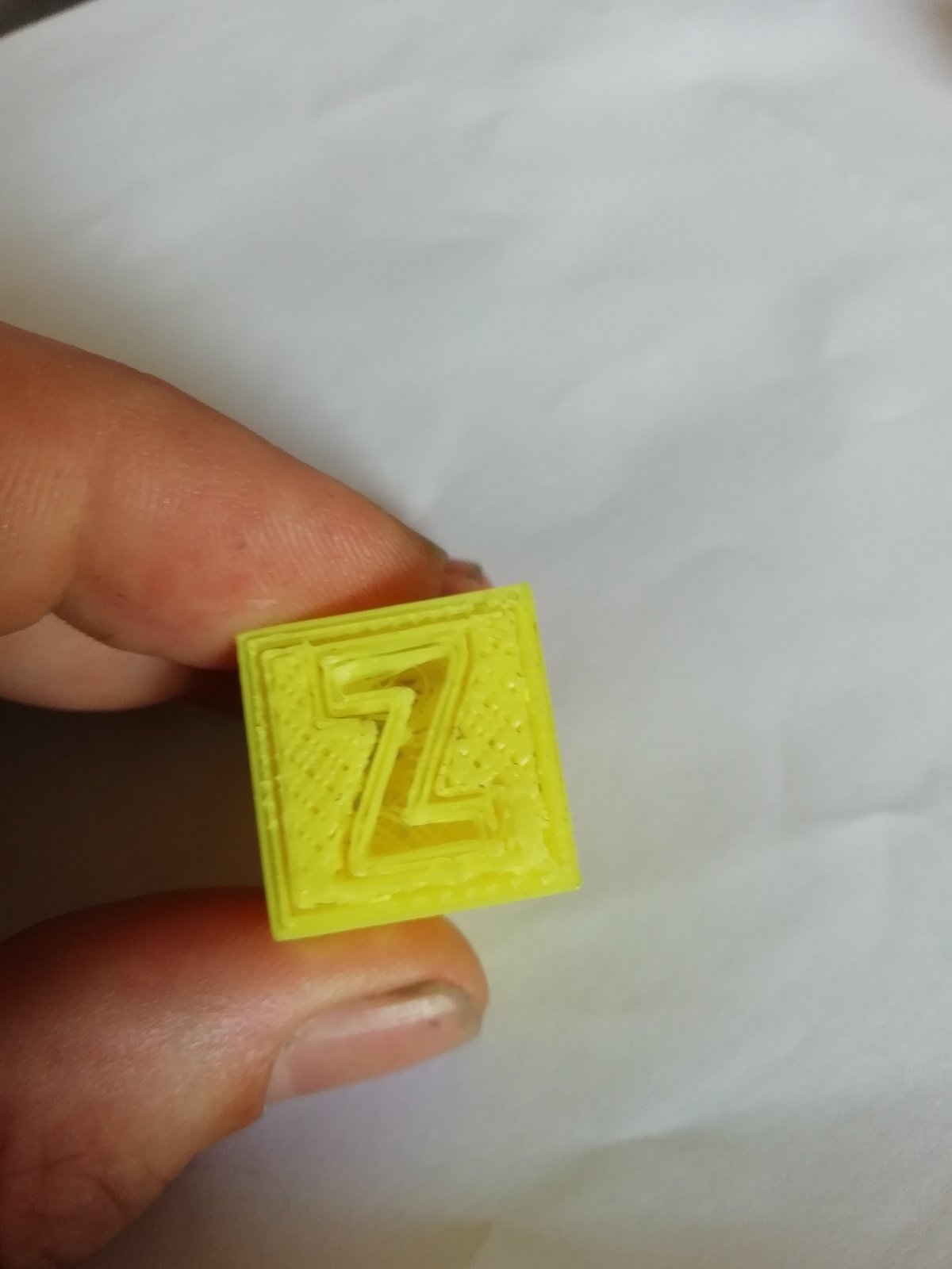

Thanks for the reply I played around with the settings last night and still very hit and miss with the print quality I have attached some pictures
This is the top layer of a test rectangle which is ok but it still has gaps
Top Layer
Top Layer
Bottom layer as you can see did not bed down very well at all, this may have been my error not to sure

The layers look good but appear to be running up at a slight angel once again this could be my fault
Side view
Side view

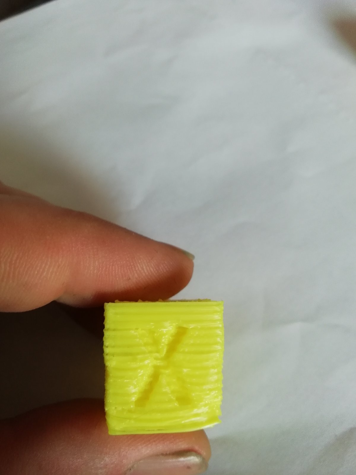

And the calibration cube is well you can see for yourself
Any input would be greatly appreciated on all of this.
The bed has been leveled using the sheet of paper method and i am using glue stick on the bed, The nozzel is set at 180 and the bed at i believe was at 80 using pla 1.75mm flow rate at 100% and layer set at 0.2 with 30% infill as per the settings on the thingiverse site.

You need to know that temperature is an individual thing for each pratition of the filament.
So you can always experiment with this setting. (Temperature settings hot end)
Have you already performed any calibrations?
