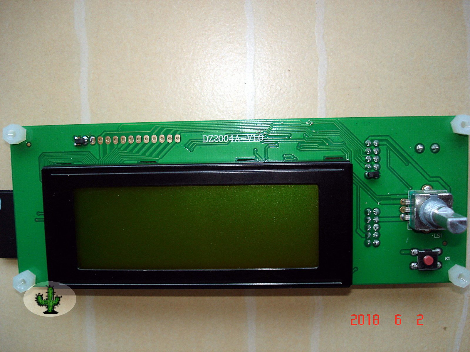

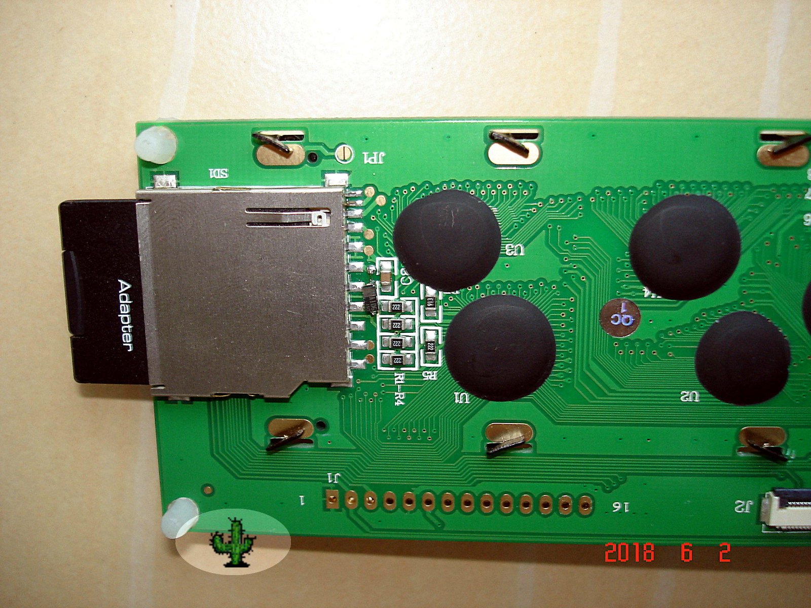

makerenzed wrote: Sat Jul 07, 2018 1:00 pm the LCD stopping working mid-print and not allowing the changes of the mix and just doing things that are unnatural
For me, this is an unpleasant reality. I call this affliction a mess on the display. :lol:
In my opinion, this mess is hardware-based and I am currently working on a solution. There has been some positive progress, but the situation is not yet resolved. :(
If you are not afraid of soldering iron I can advise you to solder several SMD tantalum capacitors.
In my opinion, there is a clutter with long-lasting prints - over a few hours. Though since I went to work with him, it's not that often that.
This can be caused by electrical non-contacts and electro-magnetic interference.
This is why the way in which the cables are routed to the periphery is important here. ;)
at the point of power supply
at the point the SD card slot
On photographs you can see where I soldered additional capacitors.
The mess on the display does not block the possibility of making changes in the menu. However, you can't see what you're doing. :cry:
