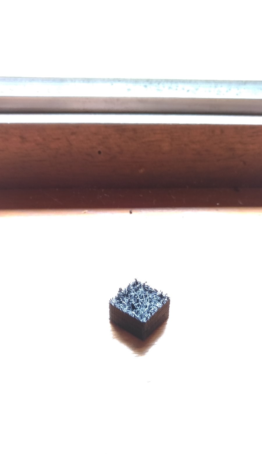

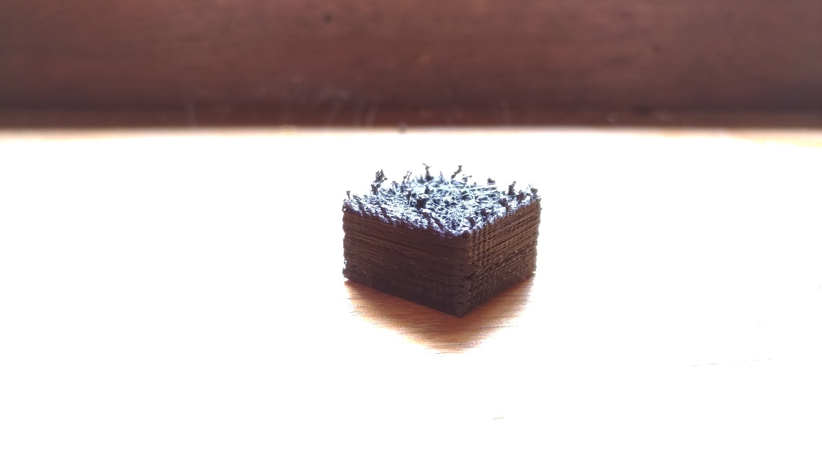

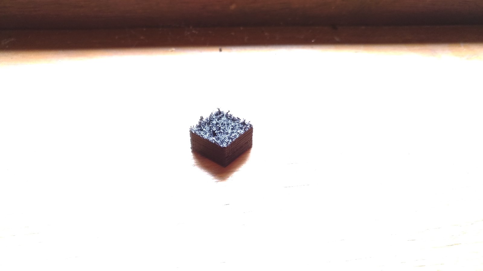

I've got my 3D Printer for a while now. Everything seems to work fine except for the extruder. When starting I try to pugh some filament in because when heatiing up the filament drips down from the nozzle. When it starts to print at first it seems fine but after a while the extruder loses contact to the print and no filament is coming out of it. I can push a considerable amaount of filament into it until there is resistance.
I found out that at some point the extrusion motor starts to do a step forward and then a step back.
I tried to adjust the voltage on the driver, increasing the temperature of the extruder to 230C, swapped the driver of the extruder with another one even switched out the extrusion gear. Everything with no success.
I'm really at a loss right now.
