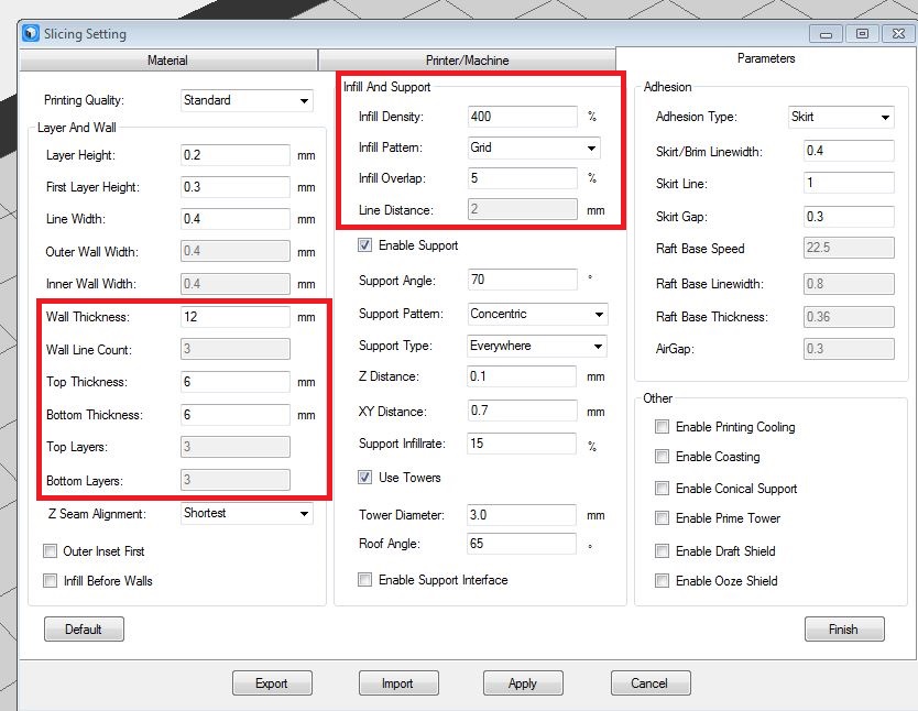

1. Changing wall thickness, top thickness, bottom thickness, infill density:
The values you enter are not the actual values (see attachment). E.g. if I choose a top layer height of 0,6 mm, the slicer creates 1 top layer. same with 1 mm, 2 mm, 3 mm. If I want to have a top layer thickness of 3 layers, I have to enter the value "5 mm" or "6 mm". Same with the infill: If I choose grid as infill pattern, and enter an infill rate of 20 %, the line distance is 40 (!) mm. If I want to have a line distance of 2 mm, I have to enter the value 400 %, of course >.>

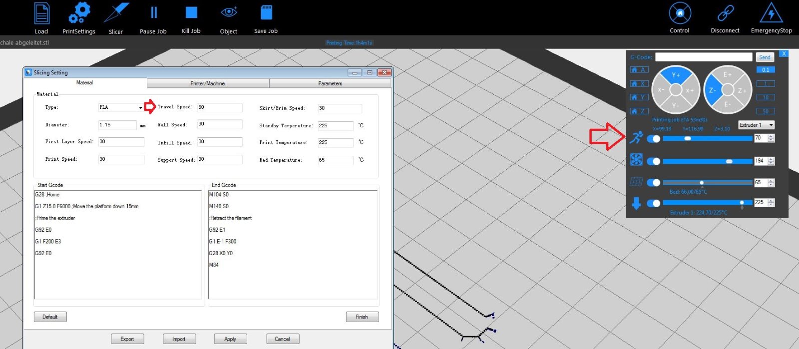

2. Control speed:
I tried different print speeds, but only some changes seem to have effect. If I change the travel speed, I can see the effect on the printing: When I chose a speed of e.g. 10, the extruder moves very slowly to the next point, when it is not extruding. However, changes of the speed in "first layer speed", "print speed", "wall speed" and "support speed" have NO EFFECT what so ever!
I took 2 hours time today and tried different speed settings but without success. Most of the part is always done in the same speed, no matter what values I enter.
Additionally, via the control interface, I can set a speed even during printing. What´s that exactly? If I set the printing speed in the printing settings, and the print starts, it shows me the estimated time for completion. If I adjust the speed via the control panel during printing, the time that the printer shows me on its own display changes, but the time EasyPrint 3D shows me stays the initial value. How does the setting of the speed in the control panel effect the actual print?

Q1: changing wall thickness... it works wrong.
A1: I saw your attachment and felt confused. The parameters shouldn't be like that. Have you ever installed an old version of EP and did not delete old configuration stored in C:\Users\{username}\AppData\roaming\easyprint before using new one? You can try to delete old config folder and reinstall EP 1.2.0.
Q2: Speed settings NO EFFECT.
A2: Maybe this problem just like Q1, it more like caused by broken configurations. EP have a debug mode. Right Click the execution/shortcut and enter properties, just adding " -c" to the end of Execution Target. It will showed you all parameters set by EP frontend which using in CURA engine when you start to slice. Please tell me the result. About time calculations, I will do some research for you.

I followed your advice and uninstalled EasyPrint, then deleted the folder, then reinstalled version 1.2.0. The settings for wall thickness and bottom / top thickness still do not work properly (bzw. also tested the new version 1.2.4, same flaw).sean wrote: Mon Jul 16, 2018 3:03 pm Hi, Kibo.
I saw they wrote in the notes of EasyPrint 1.2.4, that version 1.2.0 is experiencing problems with the speed settings. So I see my problems confirmed. Speed settings work now properly with version 1.2.4.sean wrote: Mon Jul 16, 2018 3:03 pm Q2: Speed settings NO EFFECT.
